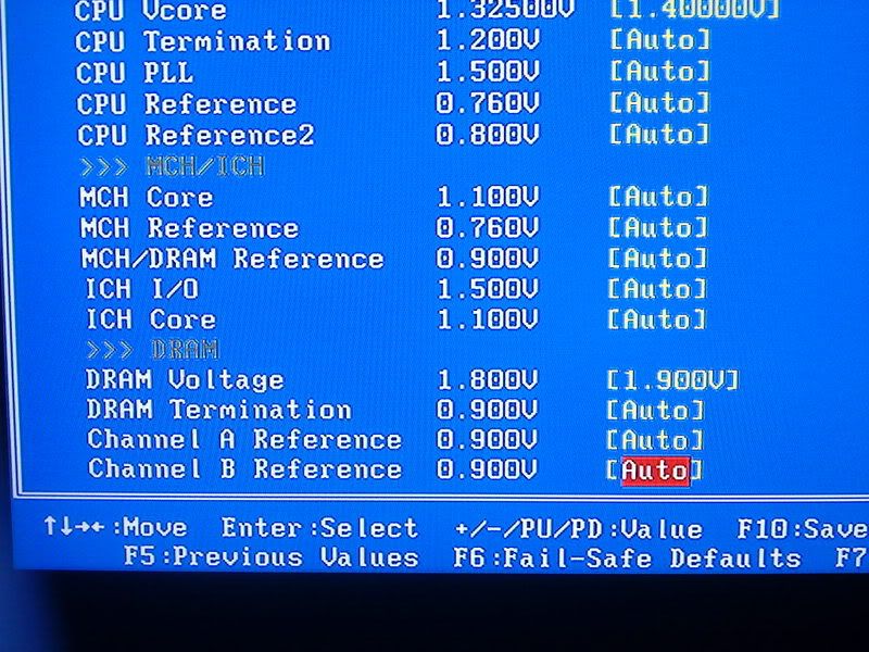

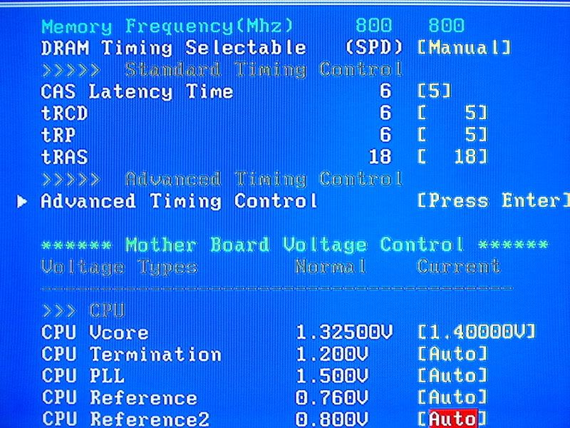

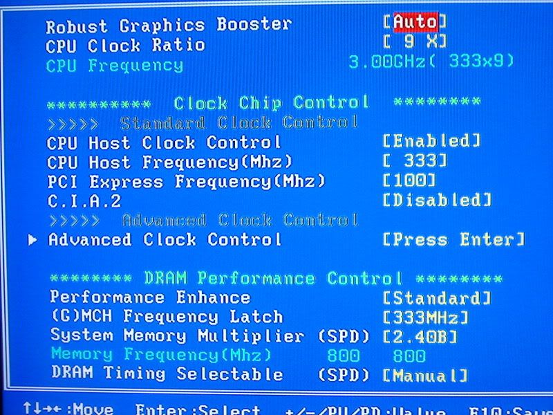

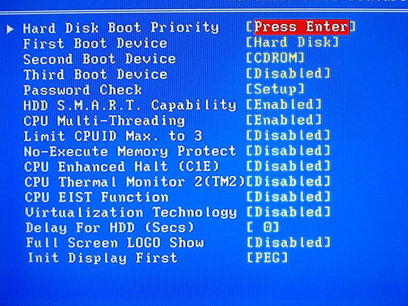

Can you post pictures of your BIOS settings please. My bet is that the memory divider is wrong and it needs to be reduced so the RAM is running within it's limits with the overclock. Either that or you haven't turned off some energy saving function and it's dying from a lack of volts at boot.
Hope this helps??
Someone tell me where i am going wrong??

I would also drop the RAM divider to 2.0 to guarantee you are only being affected by the CPU speed.
