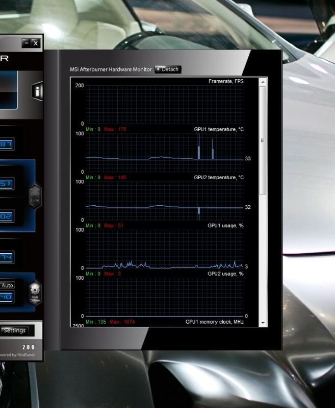

Playing a bit of bfbc2 just now, noticed a bit of a funny smell coming from the system, a few minutes later the game ctd with a juddering sound in my headphones, temps in game were a pretty decent 66-64c respectively, cpu max temp core was 56c, cards are overclocked at 751/1502/1674, stock voltage of 0.987, after shutting down via the start button, upon rebooting, afterburner reports gpu temps of
gpu1, min 0, max 175
gpu2, min 0 max 145

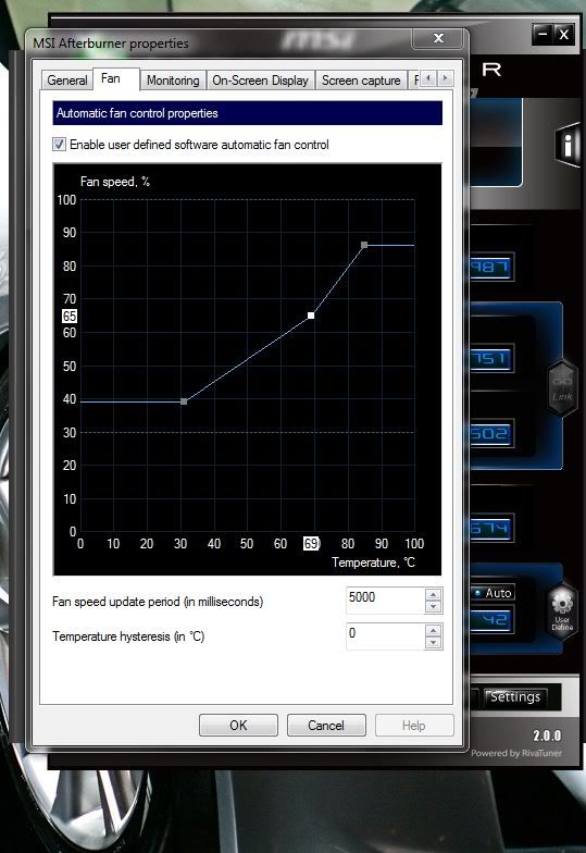

Im running the cards on a custom fan profile.
Both cards now at 35-34c.

Afterburner is now reporting temps of 38-36, 6c higher than normal at idle, using the exact same settings last night i was able to play games for a couple of hours, no probs and temps no higher than 66-64c.

Using the latest official 266.58 drivers, had them installed since release. This is the first time ive had the sound stutter crash. It was only after a reboot that afterburner showed the very high temp readings of 145, 175c. In game prior to the crash they were showing at 66-64c, gonna try a reinstall of both afterburner and the nv drivers.
