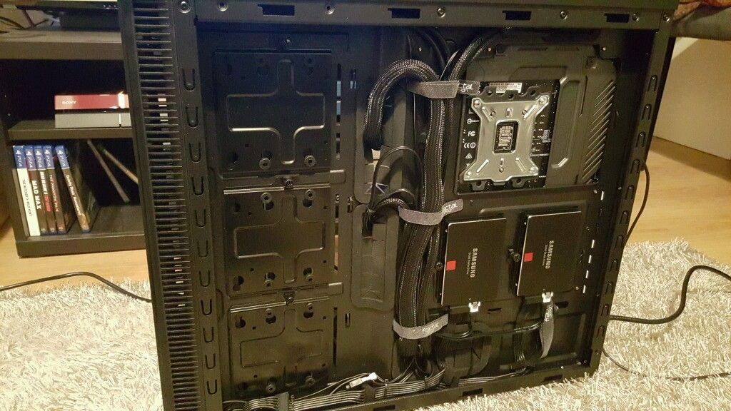

As the rig is running alright now doing some cable management looks ok atm just need to sort out the sata power cables due to my ocd.
That looks so neat. Nice-looking rig too. May want to not have that rug under it though? Likely blocking PSU intake. Maybe you just have it there temporarily, ofc.
Just had it there after doing the cables and powered it on to see if I had all the cables connected up again.
