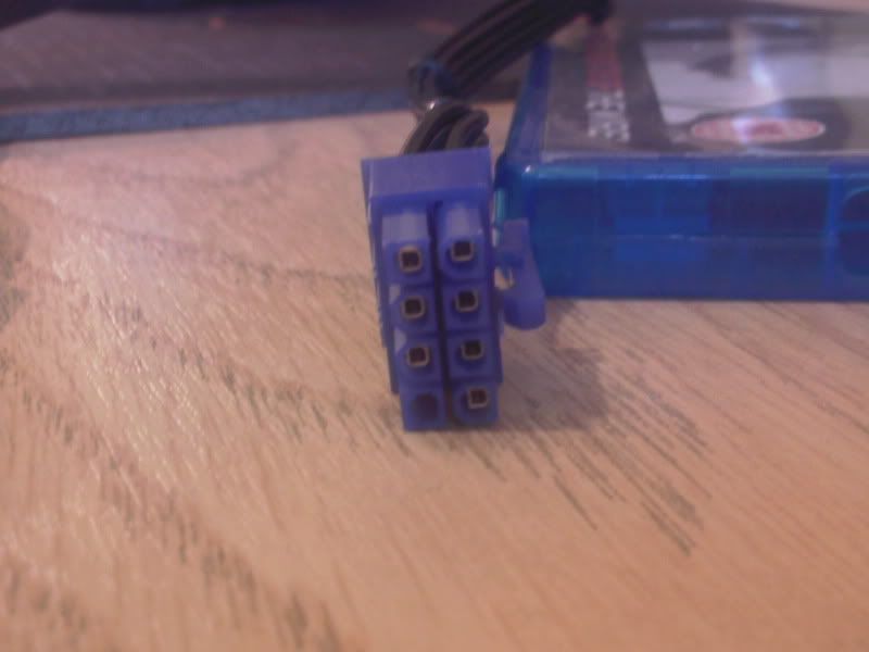

This is nothing to worry about, on my corsair hx 850w, the blue 8 pin end that connects to the psu has a blank connector.
Psu end of connector
Sorry for the quaity, my phone cam is terrible.
I can only assume that two wires emerge from one of the other seven connectors at the psu end. Ive checked all my pcie connectors and theyre the same.
