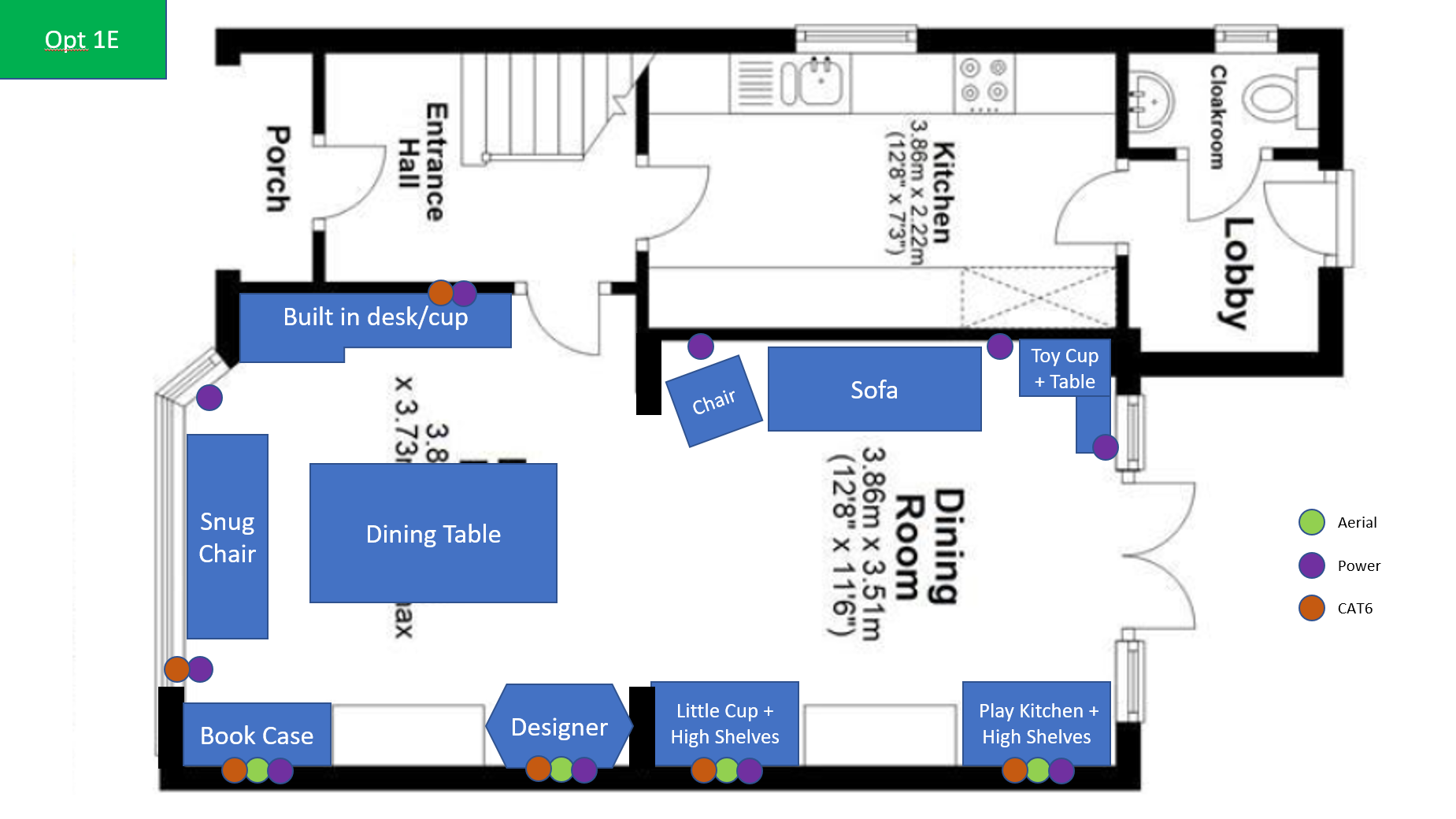

I am planning to run several network points in my living room and dining room. TBC on whether I allow TV/ethernet in every alcove (possibly OTT on flexibility front on where the TV may live) but broadly something like below:
The termination point is beneath the stairs. I'm thinking the easiest way to achieve two points per "location" is to grab two boxes of 50M CAT6 and run two at a time.

I am --- I figure downstairs following the rabbit warrens of floorboards/joists/walls/water hazards(:D) will be about 10M x5 - then I am only really planning 1 or 2 pulls for upstairs, really I just need the attic connected for the fibre modem.
Maybe I'll get a box of 50 + 100...
