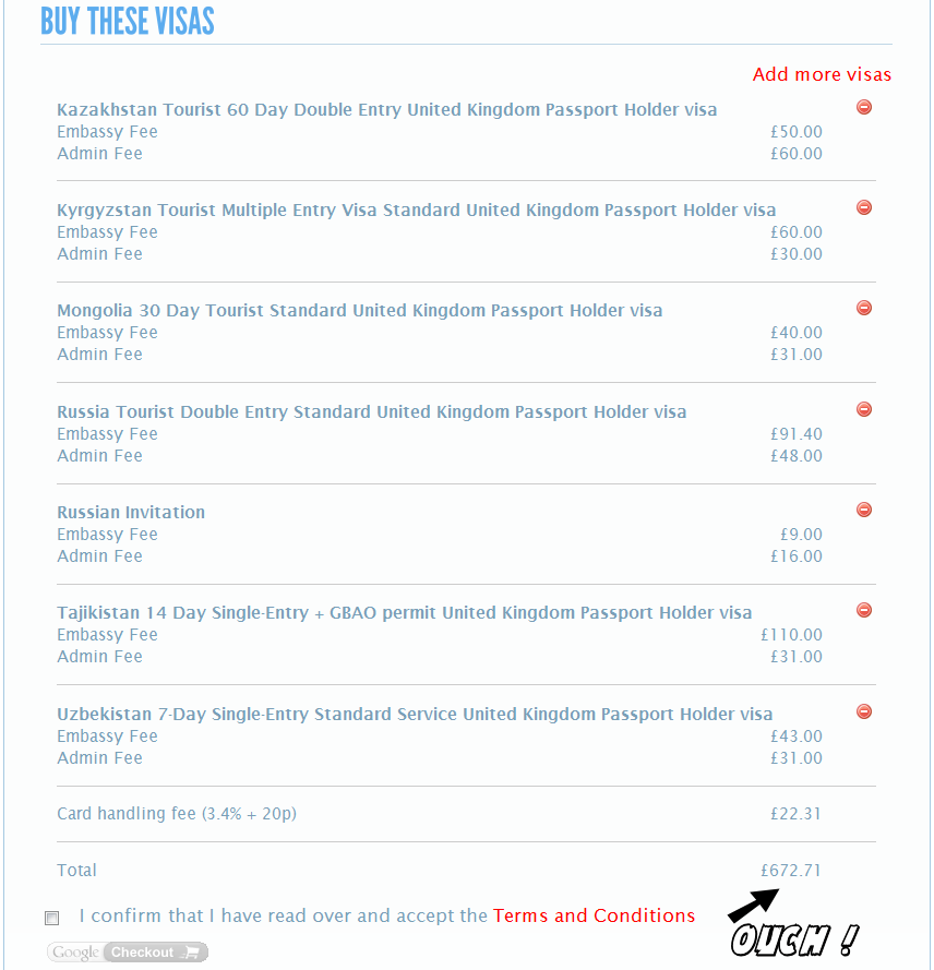

Completely off-topic, and not helpful at all, but was it difficult to get visas for the trip? I know that the Russians can be difficult at the best of times.

We are just in the process of drafting our visa selections over the next few weeks, using a company called the Visa machine, they are used by the adventurists every year so are used to dealing with what a typical rally route ends up looking like. Get a 15% discount on admin fees as well, even though i'm sure thats balanced out in other ways.
As long as we read the good instructions they have given us and take our time writing out forms etc then all should be ok.
Here's our very early draft.. :)
