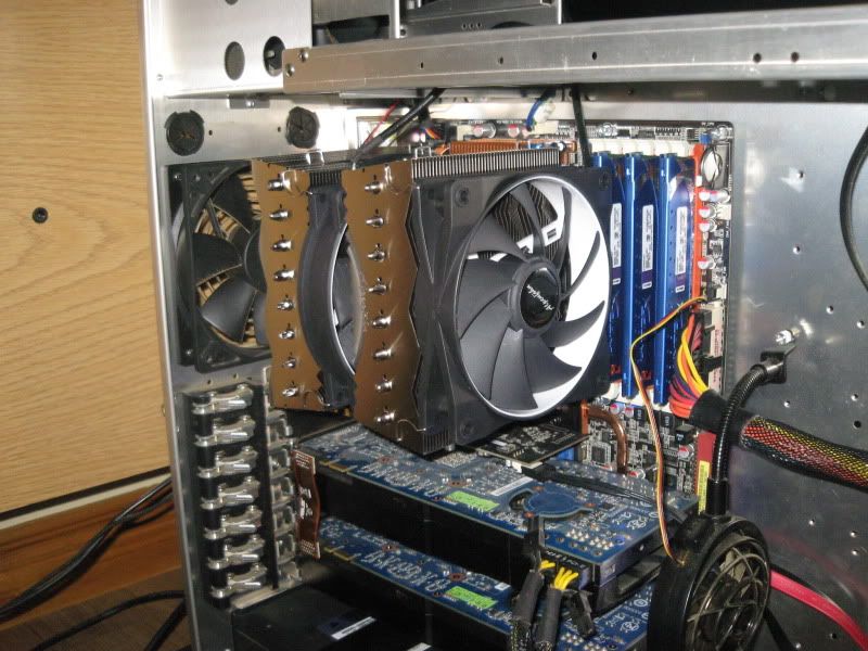

Pic to give you an idea.
Note the two extra pins sticking out the end of the connectors plugged into the top card.
