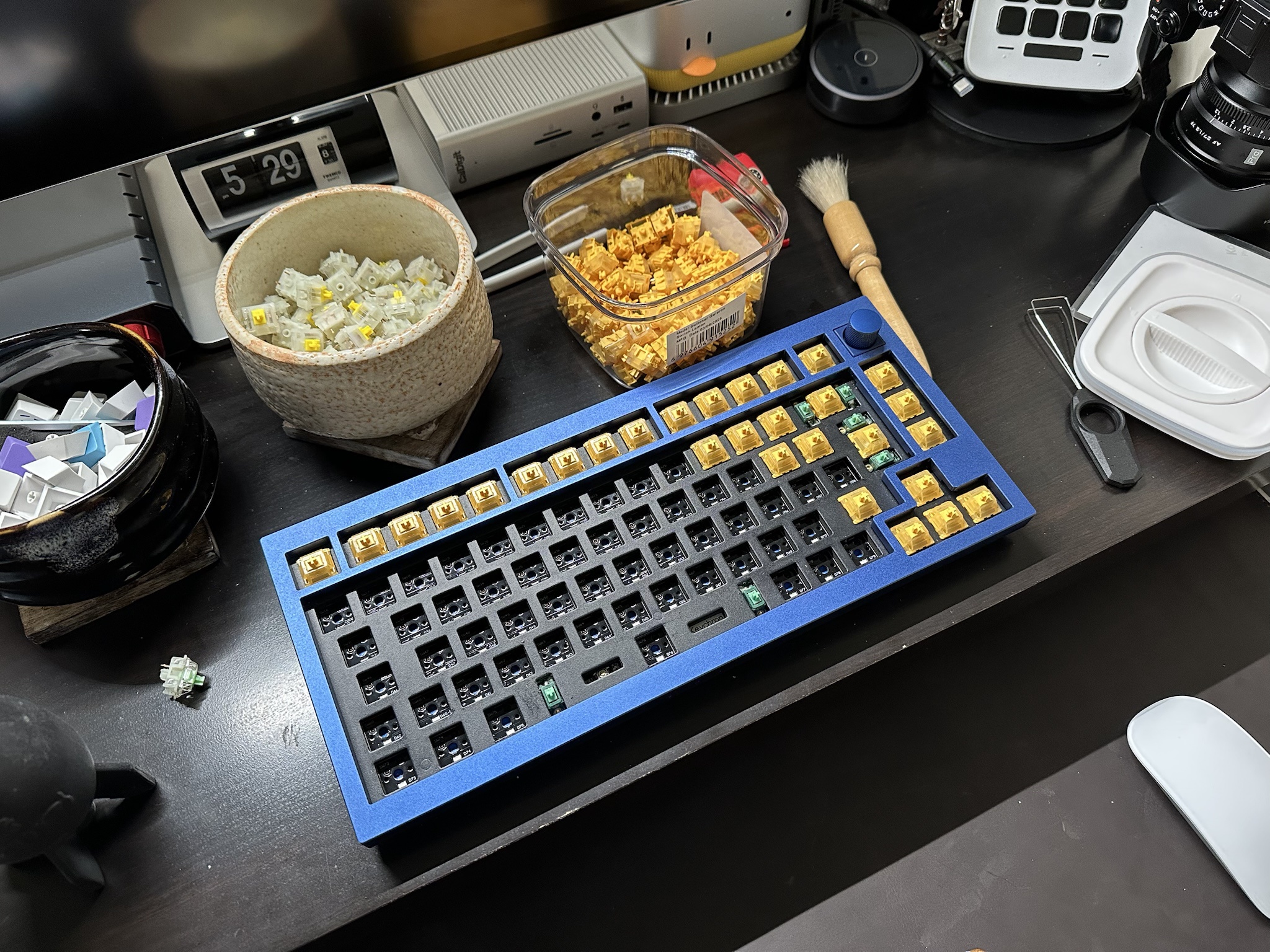

I use it as my space bar switch (I only have 1, left of the photo) and I use Nuphy Lemon yellow for the rest. The Lemon switches also have a clear top housing and allow RGB to come through but has a yellow bottom half.
