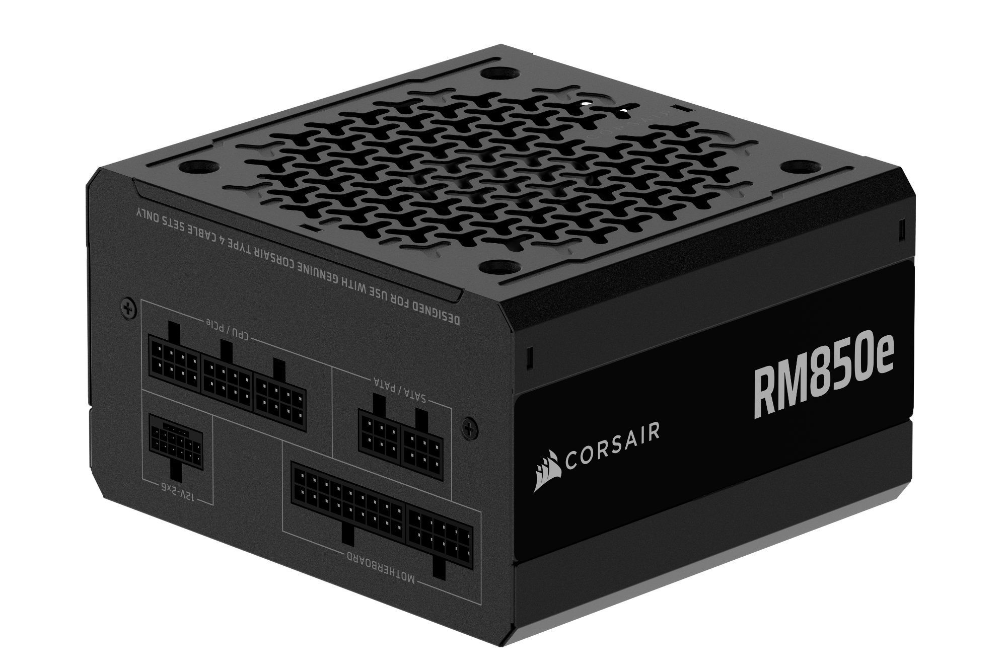

Ill be keeping the cooler (Noctua nh d15 chromax), case (obsidian 1000D) and PSU (Leadex 80plus platinum 850w) so that gives me some room.
case is fine if you want to keep
i'd swap the cpu cooler to a 360mm aio - the 9950x3d can and will use 230w at full pelt, you'd really want a 360mm aio for best performance and acoustics
psu i'd swap to atx 3.1 psu - you're needing to buy a new psu anyway, might as well put the new one in the new rig
fwiw i'm still using the original superflower leadex platinum 850w (my psu was made in 2014) in my main rig! :cry:
