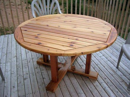

If you're covering the top, and therefore not leaving the wood exposed - why get into jointing at all? You might as well use some dimensionally stable sheet material.
There is a specific design for tables using tenon and mortice joints that allow for expansion with the wood aligned to provide the correct dimensional stability. They are often described as pub tables. I have a book with a plan in it. The joints have elongated holes that allow the board to move around the pegs so you get the wood being held with the grain but allowed to expand across it which sounds essential for an outdoor table.
Good shout on sheet material. I figured it would still be exposed underneath though. It also wouldn't look great underneath.
I don't really see how mortice and tenon type joints would work for a round table. It would be fine for a square table with an outer frame for the joins but i was just going to use this method rather than an outer frame for the wood.
Just wanted a slightly more advanced way of joining the wood as opposed to battening.
I am now however thinking this method may be a good option as it would allow me to easily make a border for the resin to sit within. Which would allow for M&T joints
I know it's not a round table but any chance you might be able to post the plans anyway, it sound interesting.
