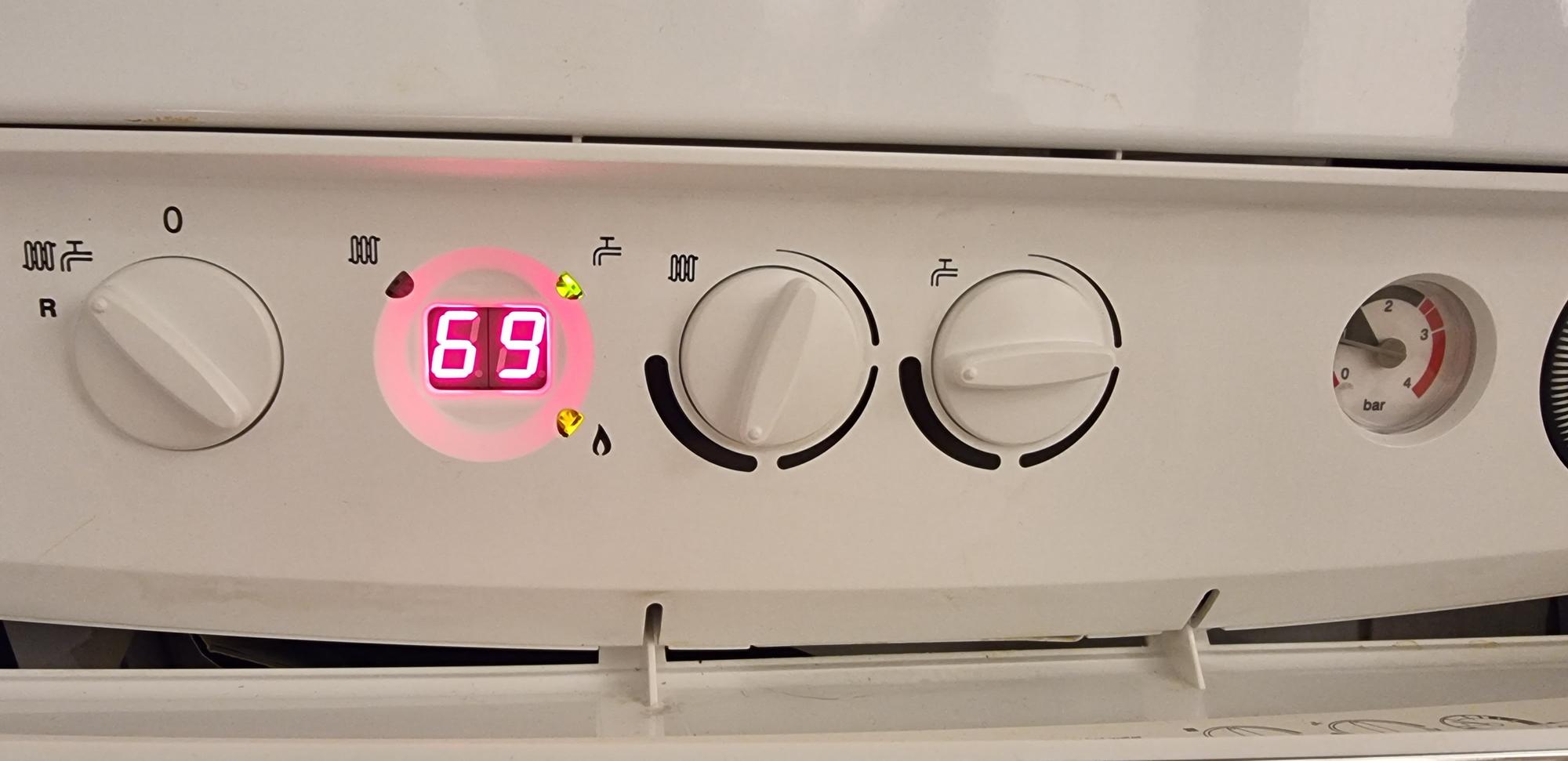

If that temperature reading is while DHW is being drawn, then it's too high!
Internally, the boiler has a water to water heat exchanger, and your boiler is showing that it has to generate 87C to give you your desired DHW temperature. So it's showing the heat exchanger is doing a poor job, and either needs cleaning or replacing.
By comparison, my 33kw Baxi runs at around 70C to give 60C DHW after stabilising for a few minutes.
The 'Comfort' setting on the boiler is a preheat feature that let's the boiler keep the DHW heat exchanger warm, so you get hot water out of the tap sooner. So less waiting time, especially good during Summer months when the boiler is 'cold'
Vaillant and Worcester Bosch boilers do the same.

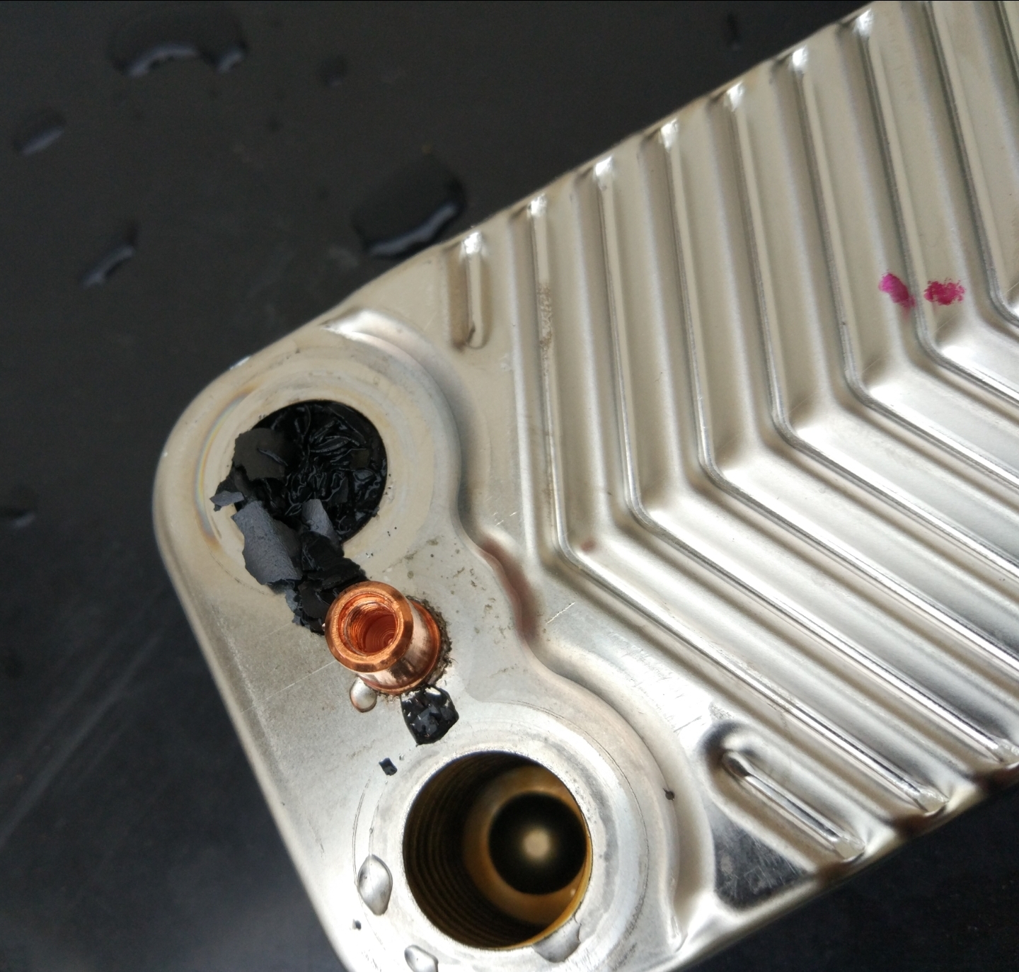

Oh and if you're interested here's a picture from a blocked up water heat exchanger from a Viessmann combi I washed out a few years ago.
It was poor hot water performance reported by the customer.
