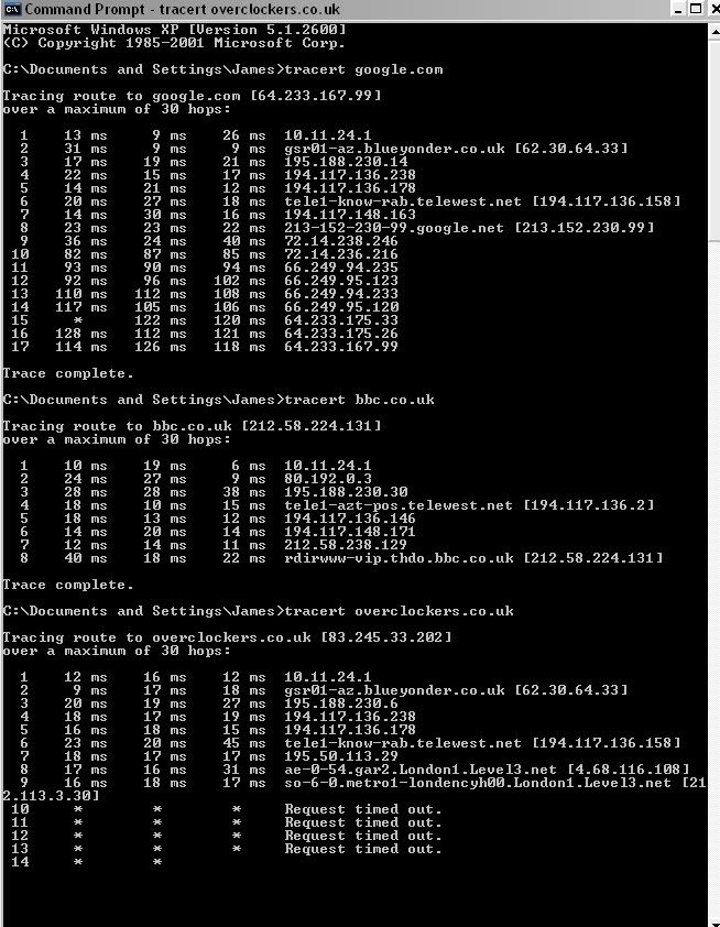

The best thing for everyone to see is your trace routes. Open up command prompt and type
tracert google.com
tracert bbc.co.uk
etc.
Then we will see if its a problem locally or outwith blueyonder's control.
squawkBOX said:
tracert google.com
Not the best one to use since google.com resolves to numerous different addresses so it'll be hard to compare traces from different people.
I usually do a trace to jolt.co.uk.
Ignore the trace to google (see my earlier post) and to overclockers as a router (or server) between you and overclockers is blocking ICMP so your trace is breaking.
The trace to bbc.co.uk looks absolutely fine though.
You mentioned that your ping to google.com was aroung 120ms, that's fine. Considering that google.com is on the other side of the water then 120ms is pretty good.
