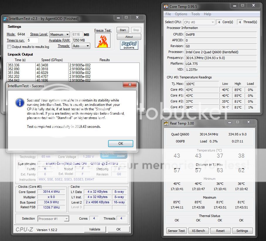

Could someone take a look at these temps. Overclock is @ 3Ghz. As you can see max temp was 85 :eek:
Cooling is Arctic Pro, 4x 120mm Sharkoon 2000
cheers
Those are extremely high for a 3.0ghz overclock, make sure the cooler is seated properly and try to see if you can lower the voltage a bit, most q6600's should do 3.0ghz on stock volts or a slight increase.
They are a tad too high IMO. My old q6600 in a p180 at 3.2ghz was running 70 degrees max on prime 95.
I hate coolers that use push through clips like the arctic.
First check that the clips are all the way through the motherboard and the heatsink is making even contact. Also what thermal paste are you using? Did you put on too much?
IBT will add far more heat then prime will do, try running ur clock on prime for 15 mins and see what the temps are on that, as most things u do will ever reach IBT loads/temps.
Generally i found that IBT added about 5c to load temps compared to p95. I had a q6600 at 3.8ghz with 1.5vcore running through it, temps running IBT were in the low 70's.
motherboard was replaced yesterday so fresh Arctic 5 TP was applied.
Have lowered the vcore to 1.2000 (slightly under) and temps seem to idle at 40 and under prime max 58.
Temps seem a bit more like it under p95, ibt will make things run a bit hotter. How much paste did you apply?
