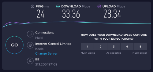

Hi all,
I am using a bonded broadband service with its own hardware bonding router; my WAN input 1 ADSL broadband and input 2 is a 4g router. The bonding service interface shows me the speed test for each line. This also matches if I perform the same test directly on each WAN.
Problem I have is that the LAN output from the bonding router never seems to provide me with anything more than the highest of a single WAN.
Before anyone asks yes its a bonded service not a load balancer.
I also know that bonding is not just about speed but about resilience, so far it does very well and keeping my connection stable.
However, its meant to provide about 90% of the combined total. For example:
WAN 1: 60Mbps (stable as fixed line)
WAN 2: 60Mbps (more fluctuation as 4G)
Lets say I should see around 100Mbps down for arguments sake, but speed tests show no more than 60Mbps.
The company have said that speed tests lock on to one line so should not be used. I have however compared it to a real life example of fetching a 1Gb file from S3 for example. Still no quicker.
I just wondered if there is anything else worth trying to use to ensure performance of the bonded service vs the single wan’s
I plugged wan1, wan2, lan(bonded) into my mac directly one at a time, performed a wget on a large file and all three had similar results.
Any help would be much appreciated, the bonded service have said they can’t help much more than say that the two lines are aggregating whatever the platform says for each wan, anything beyond that is down to the LAN.
I am a software engineer so I understand this stuff enough to test it to a degree but advanced networking not my thing. As mentioned I know there is much more than speed tests like throughput etc but still not convinced I am getting anything more than a decent load balancer.
Thanks in advance for any advice!
