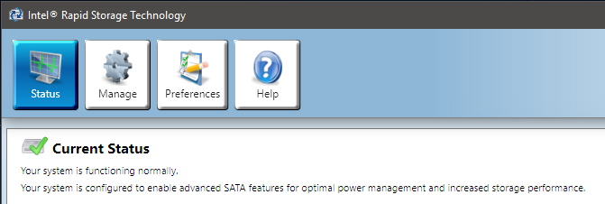

- does anyone use intel rapid storage drivers?

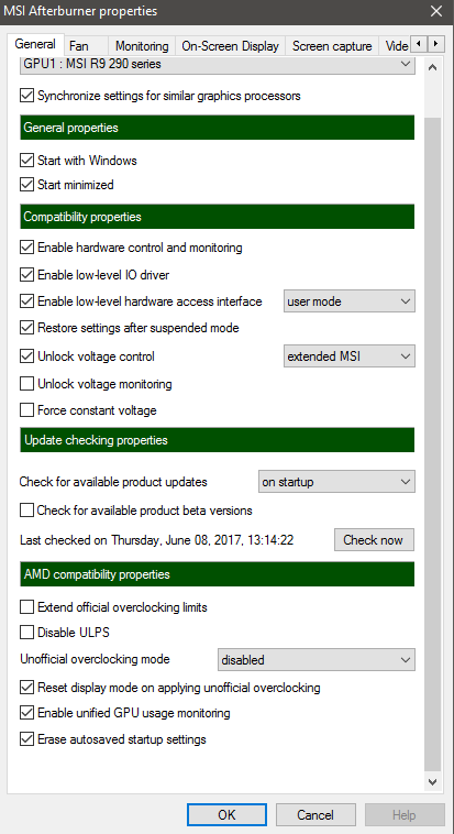

- for those that still use MSI AB to undervolt, do these settings look ok?
And I've tried to just use AMD's wattman for undervolting but it is too much faff with all the power states and I can't seem to get a stable undervolt with it either, MSI AB is super easy with just there being one slider to control.

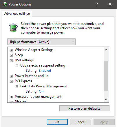

- Power plan settings?
Can only answer Intel question I have this driver installed I believe its the only driver I can install for this series Z77
This driver installs the main Intel chipset for Sata driver and is defo a must.

I use Parkcontrol this switches between low power and high performance on the fly depending how long I have not touched my PC.
I use High Performance mode and Intel RST drivers but I use WattMan to undervolt and overclock (MSI Afterburner just for fan profile). I don't get driver crashes but after I found FireStrike "stable" settings I still got a couple of game crashes and just bumped up the clocks by 10 MHz each time until it stopped happening.
The only downside to using WattMan to undervolt, IMO, is that I can't be arsed to figure out what undervolt would work on the lowest power settings. I've only done it for the highest performance mode (and copied that voltage to the top 3 states). Considering my GPU runs cool anyway I don't see much point undervolting the idle and video mode voltages.
I tried downloading and installing the latest intel RST driver from intel's site but it says my platform isn't supported..... Looked at my motherboard site:
https://www.gigabyte.com/Motherboard/GA-P55-UD3-rev-10#ov
But all outdated, max supported is windows 7.
Any idea if I can install intel RST on my windows 10 64 build some other way?
Check out Station Drivers, see if you can find your motherboard on there.
Yeah I'm sure if I give the time, I would find good undervolt settings with wattman but for now, it just seems incredibly tedious, spent 30+ minutes adjusting and just couldn't get a result as good as MSI afterburner.
Hopefully with vega, temps and noise will be great so I can then just drop MSI AB and wattman all together....
Station drivers would be the best place to find. Think my driver is also window 7 dated 2014 I think
Edit
Don't look for motherboard, head to Intel under drivers and storage see if you can find a newer driver.
You can usually find the latest versions for the various chipsets on the win raid forums.
http://www.win-raid.com/t29f25-Recommended-AHCI-RAID-and-NVMe-Drivers.html
