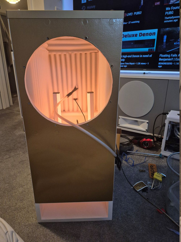

I unpacked it, which was a mission in itself. I then fitted all the foam panels using the diag I made.

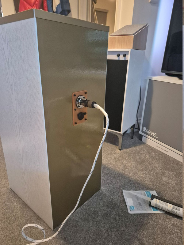

I then fitted the rear terminal. This was sealed in with some silicon sealant.
Then fitted the rear plate.
Boshty.

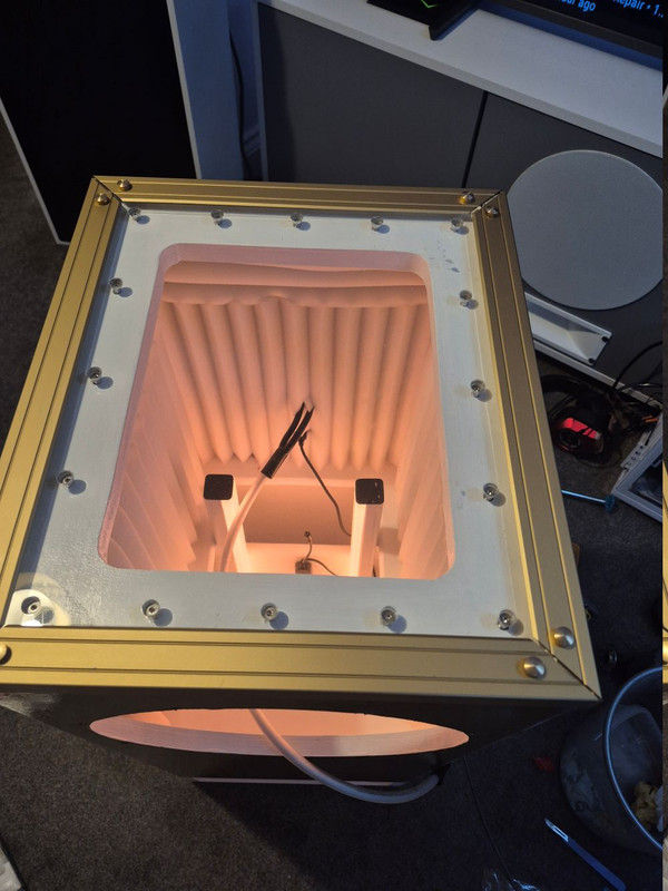

Fit LED bars.
Test.

And finally the sub.

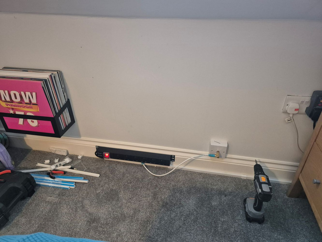

After that ordeal was over I started work on the area where the new sub will live. First I gave it a big clean, then started fitting the sockets etc.
That led me up to last night. By 10pm the sub was located and is now up and running. The DSP has been wall mounted, among all other sorts of small jobs etc. I will upload the final pics at some point over the next few days, as this big project also meant I now need a coffee table (my old sub used to be it lmao) and some home improvements etc.
