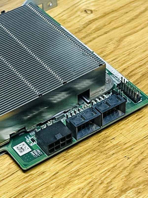

Here, look.
That part of the board sticks out from the rest. Making it taller. If I plug the PCIE power into it I will have a plug and wires coming out making the case taller. I don't want that. Note how the solid wire things from the socket go in 90 degrees? well if I remove the socket I can solder the wires in "sideways" meaning the case does not need to have clearance for a plug and cables coming out, making it taller than I want it. Obviously this then limits the PSU I can use to the one I bought, but I am sure if that failed I could desolder said pigtail and replace etc. That is why I bought that exact Flex ATX PSU and not one of the 10 quid jobbers from the bay of fleas. Because otherwise the PSU would have had to be permanently connected by an umbilical cord to the plane.
Nashty.
I meant to not do that and try to recreate the plug-in style of connector that would have come with the original chassis that these blades slot into. It would increase the size of the case and the complexity of manufacture... but it would have cool factor! :D
If you wanted it pluggable without the extra space, you could always swap the 90° socket with a straight one - still a bit more space but in a different plane that probably has the space anyway.
And yes, I always need more coffee!
Yeah I could swap the socket. Not going to though :D I doubt I will ever change the case around, or the board. It's sort of just a one go deal.

I think I could reuse the socket on there. Well, if there is enough meat coming out of those spoke things before the bend !

Unfortunately for the life of me I can not get the PCIE connector desoldered. Nothing worked. So I need to make it slightly bigger. And it was at this point I had a cluster fudge and ended up deleting the project on Easel lmfao. Even more annoyingly the files I need are all at home. Still, I am not sure why I got so angry as I don't even have the plastic yet lol.

What is nice is the silicon cables are extremely flexible. So yeah Ill just make it 10 mil bigger in both directions which is fine with me. I just don't want to break it which I will if I keep hamming it.

Presuming you are using hot air and not just trying to somehow wick and replace with an iron, I'd try giving the entire board some baseline heat first, might take a while with the heat sink on but with big mass like that a lot can soak in and cause difficulty getting big components off (happens with HDMI on consoles for example). Perhaps pop the heatsink off while performing the soldering job.
