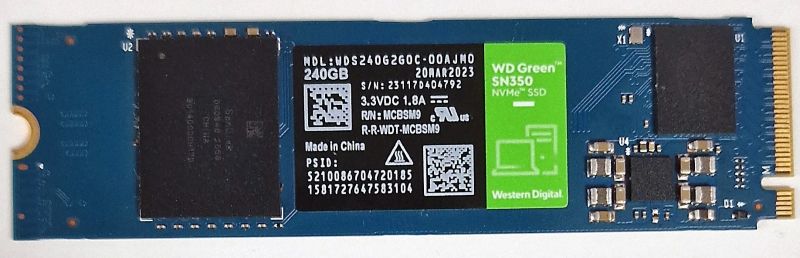

I am now waiting on the SSD to arrive. I did not splurge on a 1tb yet, instead grabbing this from poo bay for 12 quid INC.
It's not often I exhibit common sense but yeah, I should do that before spending big on a drive.

Hopefully I either have more luck than Hamish, or, Bazzite have worked on the WIFI issue. It's patchy apparently. Hamish tried another USB WIFI adapter but it seemed more OS based. That will be a problem here as nothing is wired. Still, I should be able to get it installed in the very least tomorrow when the drive comes.
Bah. For some reason I incorrectly thought this thing had WIFI of sorts. It does not. So there wasn't an awful lot I could do. I have since ordered a dongle, as wired here is not an option. Fitted the NVME cooler and put it in the board.
And install.
Next up select the drive.
Do note this bit here takes ages.
