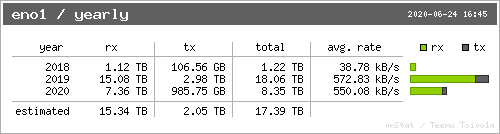

Edit: I knew I'd forget something. I also need to install vnstat and see if I can copy over the old database. I managed a round 12 months of stats out of the outgoing Arch Linux router so it'd be nice to keep the stats rolling on. If not I'll have to start again. :(
