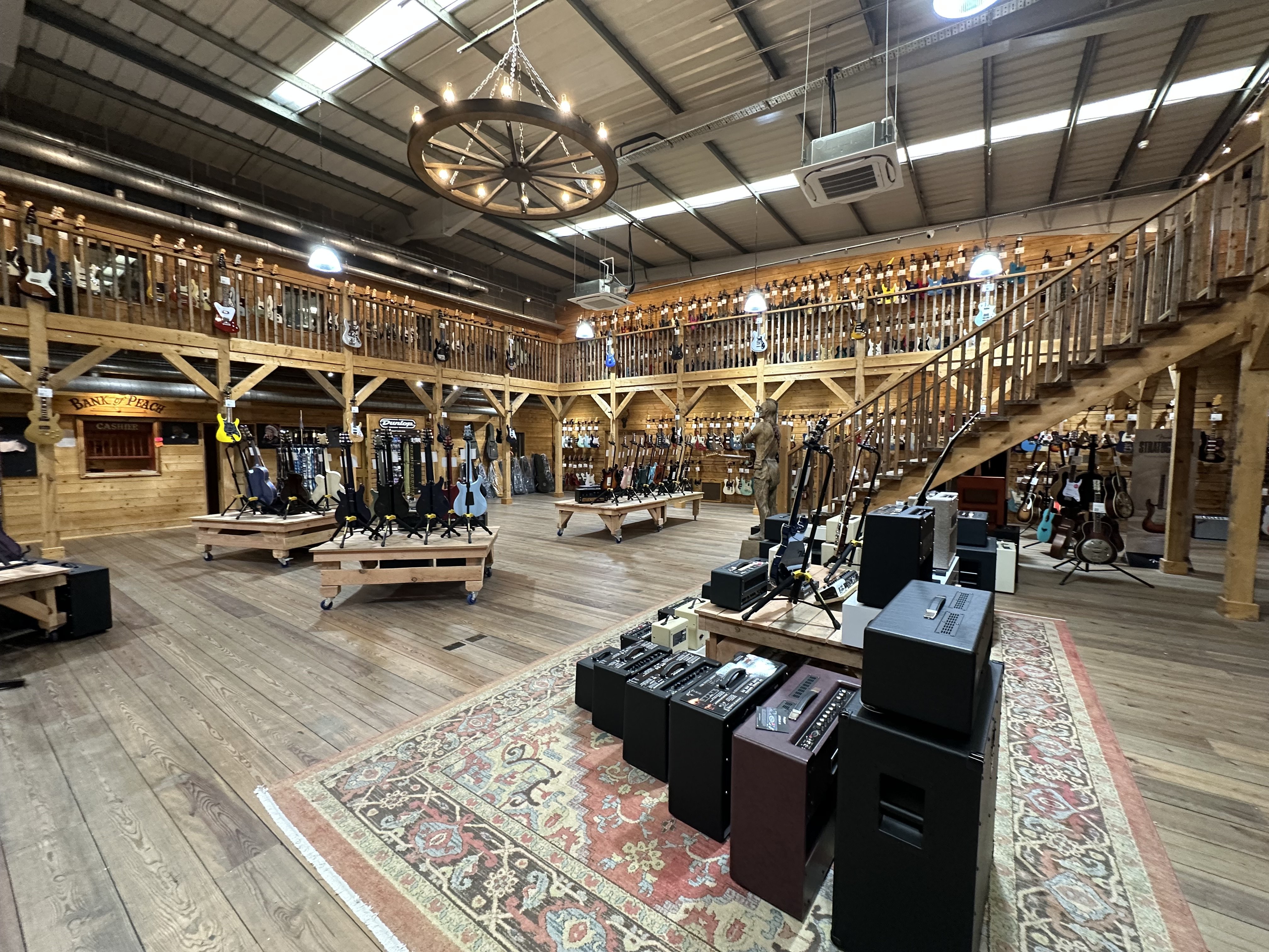

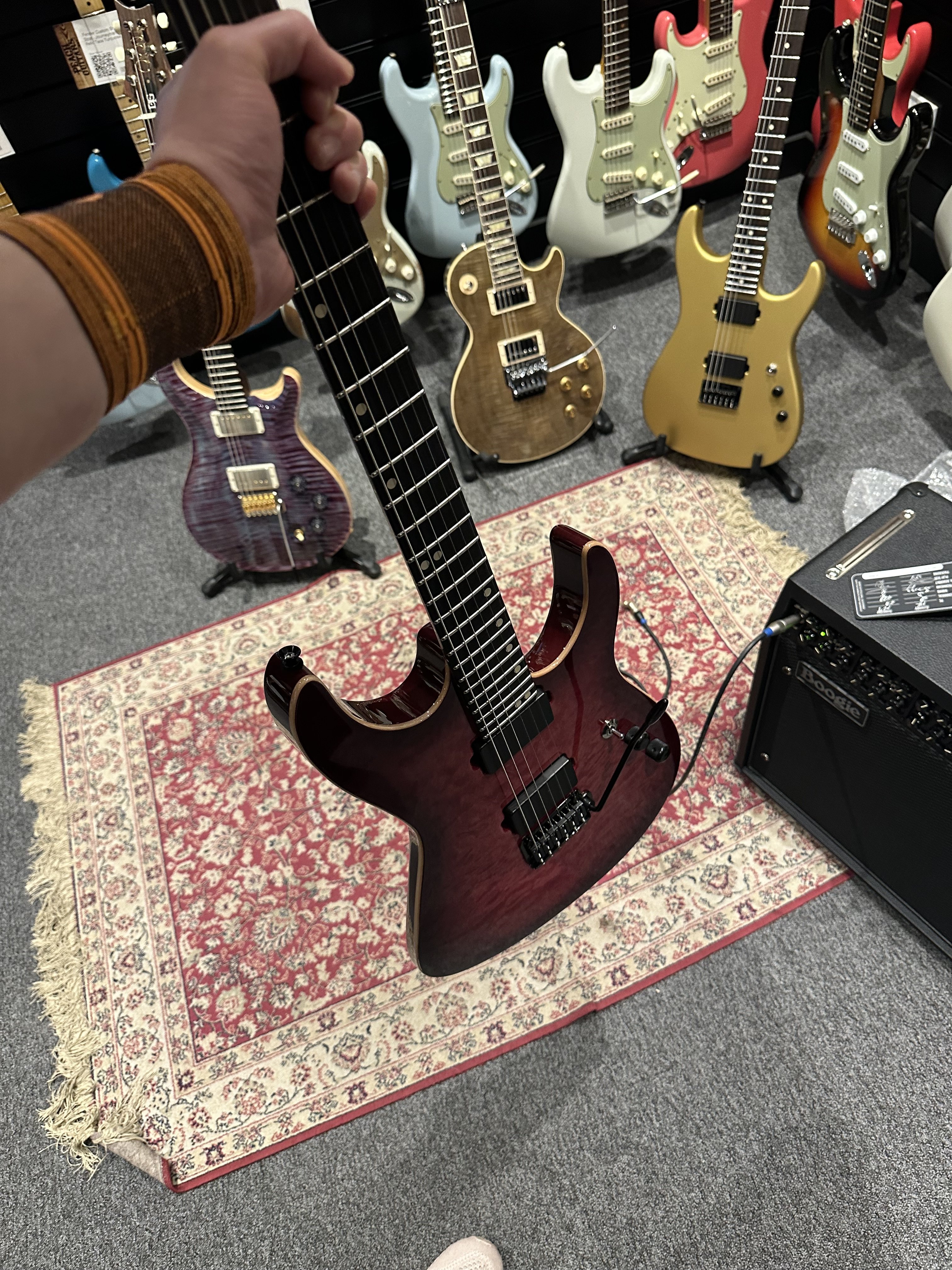

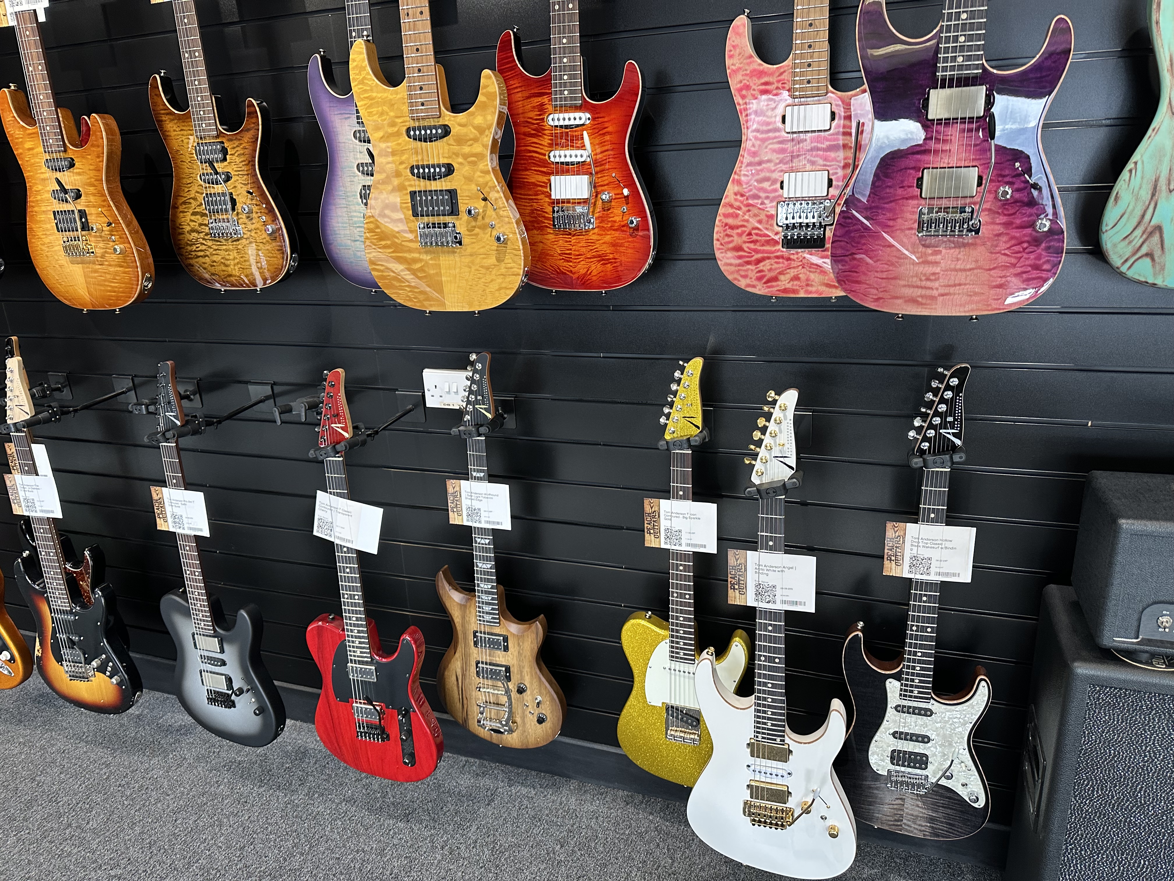

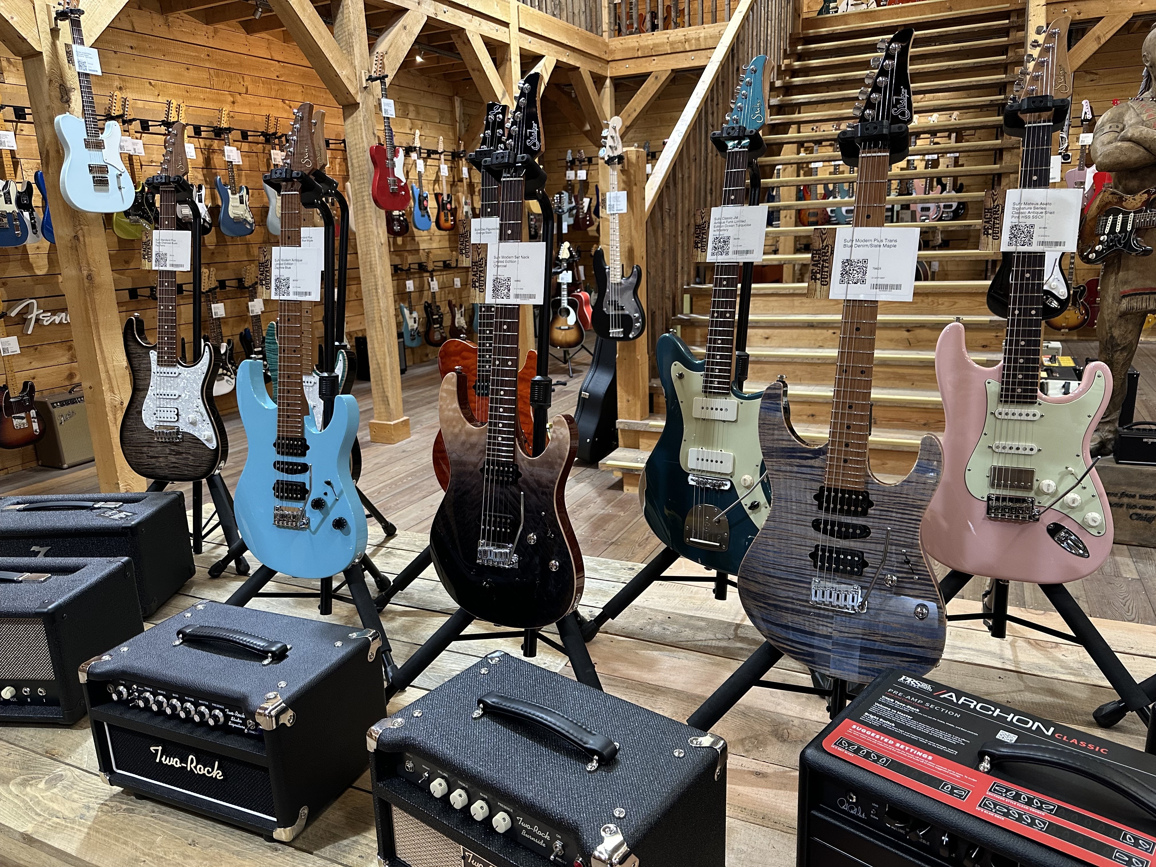

I went to Peach Guitars this week and it absolutely blew my mind. Check out these photos, phwoar! :eek:
The image of me holding the Tom Anderson shows some of the guitars I tried out; I was gauging whether neck depth made a significant difference to wrist discomfort… my conclusion was… not really. Although I didn’t really play anything skilful, as I’ve been mostly ‘down tools’ the last few months and I didn’t want to play anyone’s material for fear of embarrassingly messing it up.
The Gibson Custom Axxess (sp?) guitar sounded amazing, just had a bit of extra fullness compared to the TA pickups, but the TAs were in a league of their own re: necks. I dropped off my existing TA for a Plek job, possibly a bit pointless as it has stainless steel frets, but it wanted it set up to pro standards in E flat so why not have it health checked and Plek’ed at the same time.

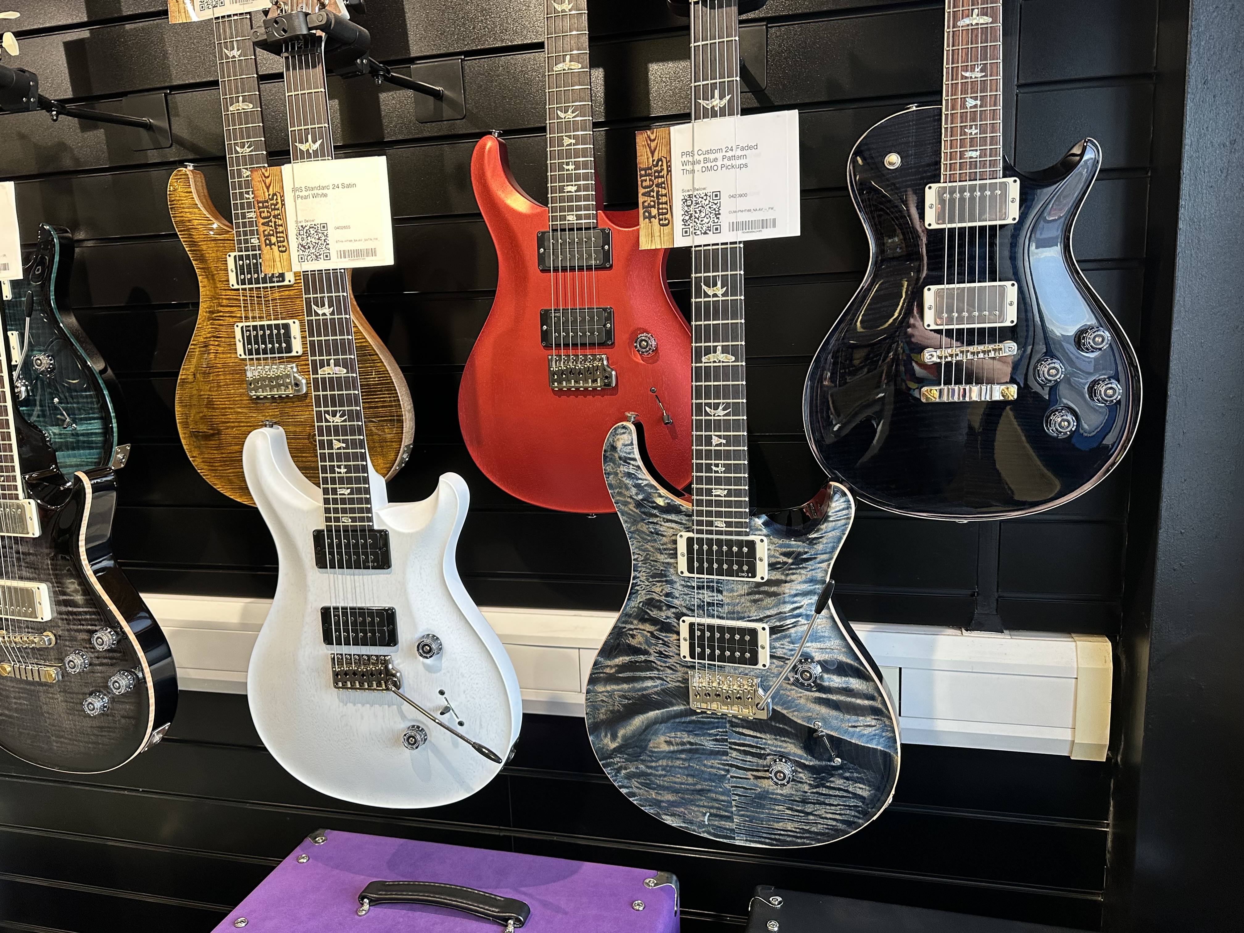

The PRS with the DGT looked beautiful but the neck was blergh, it was all grainy, 100% rosewood I think… whatever it was… nope not for me. Also tried a Strandburg with the ergonomic neck and fanned frets which was pretty interesting!
