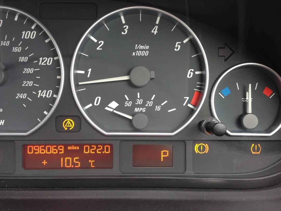

Car in question is a 2004 e46 330ci convertible.
Last week I had the front bushes changed, new front tyres and tracking done on the same day. The day after, on the M1 I suddenly hear a beep and my dash has lit up like a Christmas tree (picture below).
When searching on the internet, many have advised to get the steering angle sensor reset after getting tracking done. I did that using Edibas Tool32. Made 2 journeys that day and the lights did not come back on.
Car has been sitting at home since, so today I took it out. Drove about 25 miles on the M1 again and the same happened again. Reading the ECU for fault codes with the lights on and off gives no errors.
What I have noticed is that the lights will only come on when I turn the steering wheel to a slight angle to the right (at a certain degree). Switching the car off and back on turns off the lights but as soon as you have to steer and hit that angle it comes back on. Only happens if the car is moving.
Any ideas?

I have also found that the steering angle sensor was out by 1.something degrees so I have reset that. Fingers crossed that solves this issue :(

Just an update, following the re-calibration that I have done 3 days ago I have had no light come back on :D
I have done about 150 miles since then, fingers crossed that this is the end of it :D
