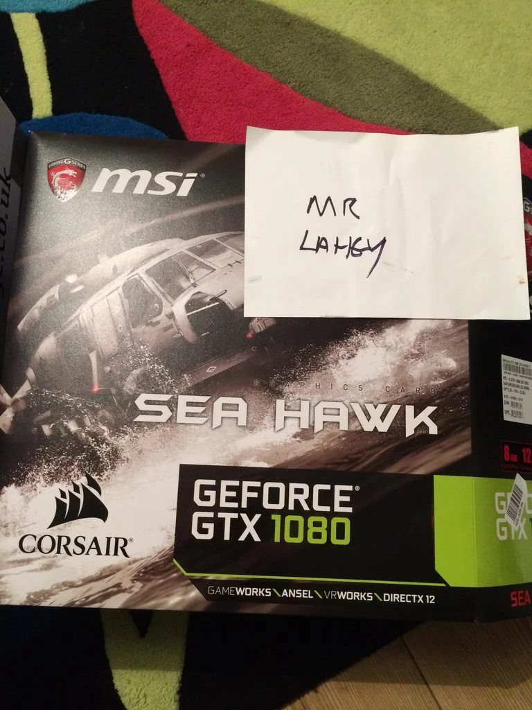

Welcome and on TROH.:)
The Roll of Honour.
Date 01/08/2016, Make MSI Gaming X, Vertigo1, Link
Date 01/08/2016, Make MSI Sea Hawk, Mr Lahey, Link

To get on the Roll of Honour all you have to do is post a pic with your user name on it of your GTX 1080.​
