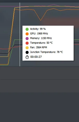

There we go, proof it can be overclocked and undervolted and the HBM also, I KNOW there is a dip there, it needed slightly more mv than i gave it but its 1:30am and i will carry on tomorrow.
Point is, the memory doesn't go down to a locked 800mhz, it stays at 1150 for me 1245 for @Vince
And I can make the core lock at a much higher mhz which gains scores in benchmarks.
I will do this properly tomorrow for everyone to see

How did you achieve this? I can't even get mine to 1900 :(
I can only get oc frequencies in window mode not in fullscreen
This I was going to explain to everyone today.
Vince discovered that the auto memory overclock button worked and really well.
I then discovered you can lock the core at 1900 with both white bars, adjust the mv to your liking. set +20% power limit, adjust the fan curve then press apply.

Press the auto memory overclock button and hit apply.
It will apply the memory and core oc with the manual fan curve and other tweaks you did
