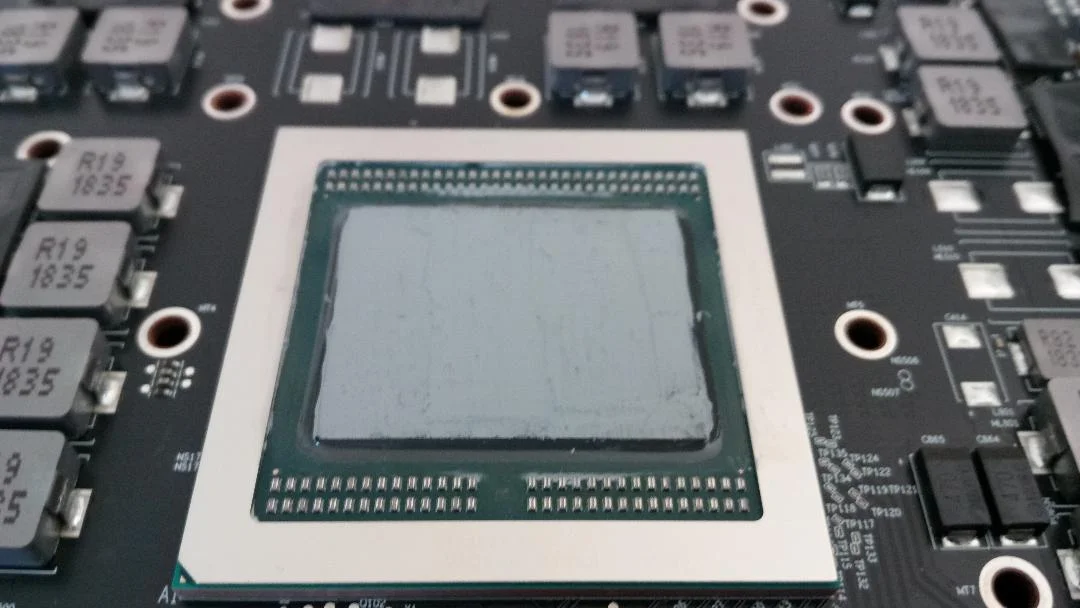

Which thermal paste i should use with the bykski block, will install it tonight, Gelid GC-extreme or Thermal Grizzly Kryonaut?. Been reading some comments and i´m little bit paranoid about the paste drying out on hotspot temps, Gelid atleast is very thick stuff.
Thermal pads :)
I'd use "Hydronaut"

And use loads, my temps are very good now I changed to an EK block. 34-35C in games now!
I just used the whole tube that came with the EK block!

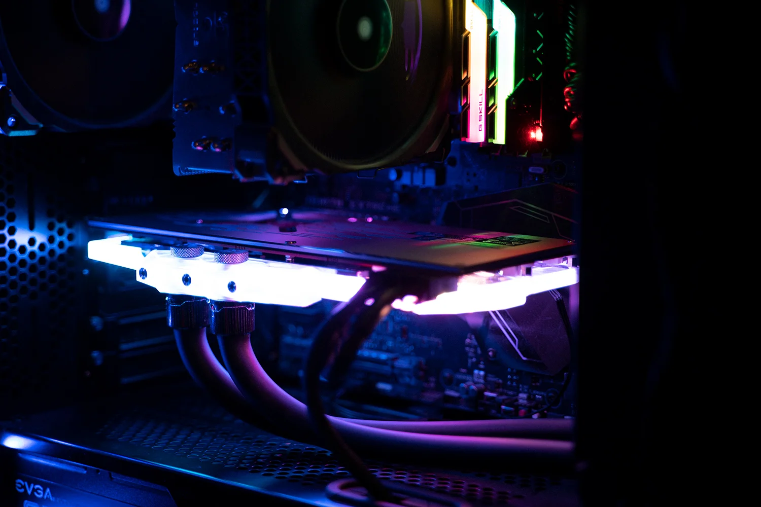

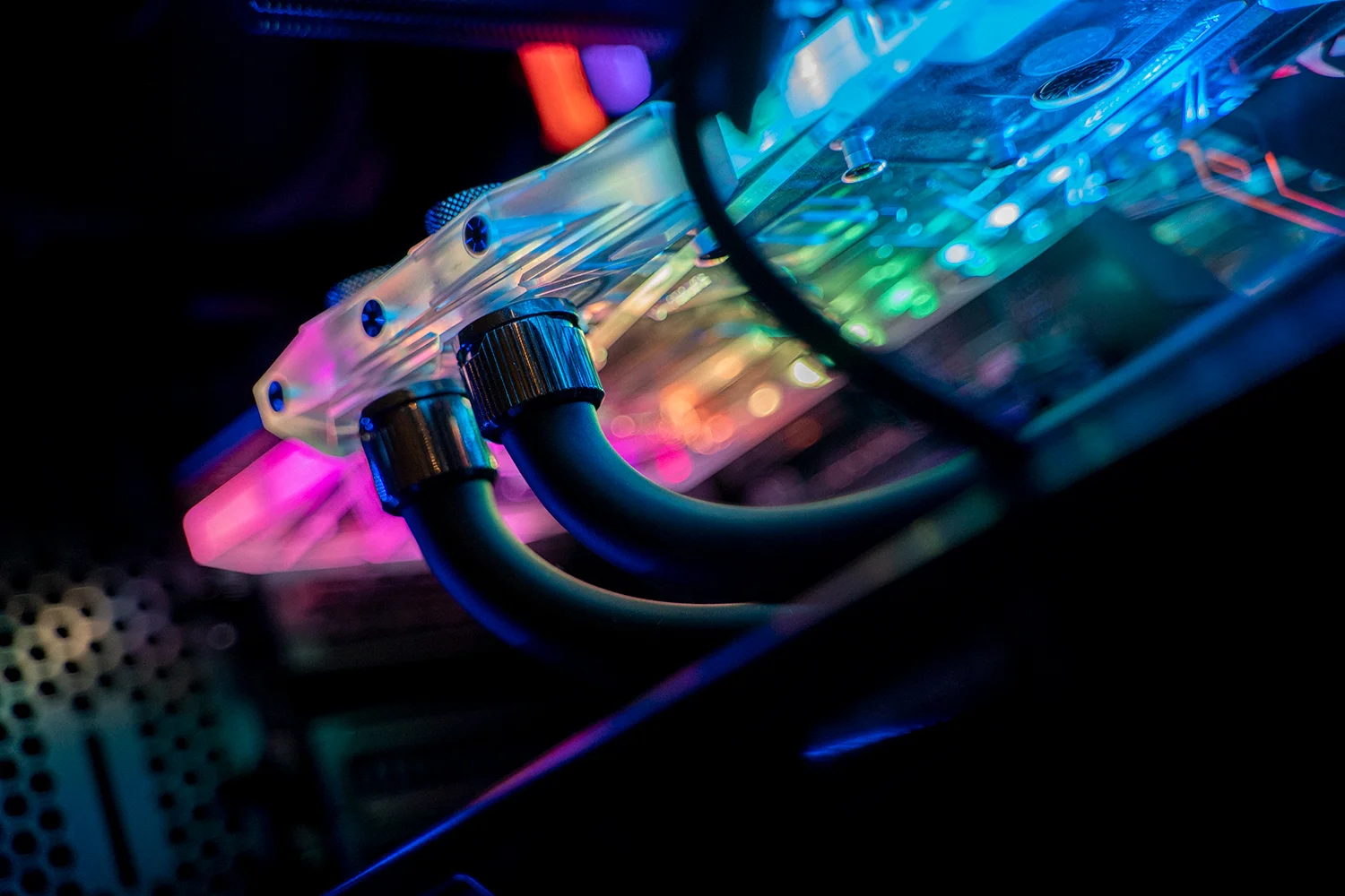

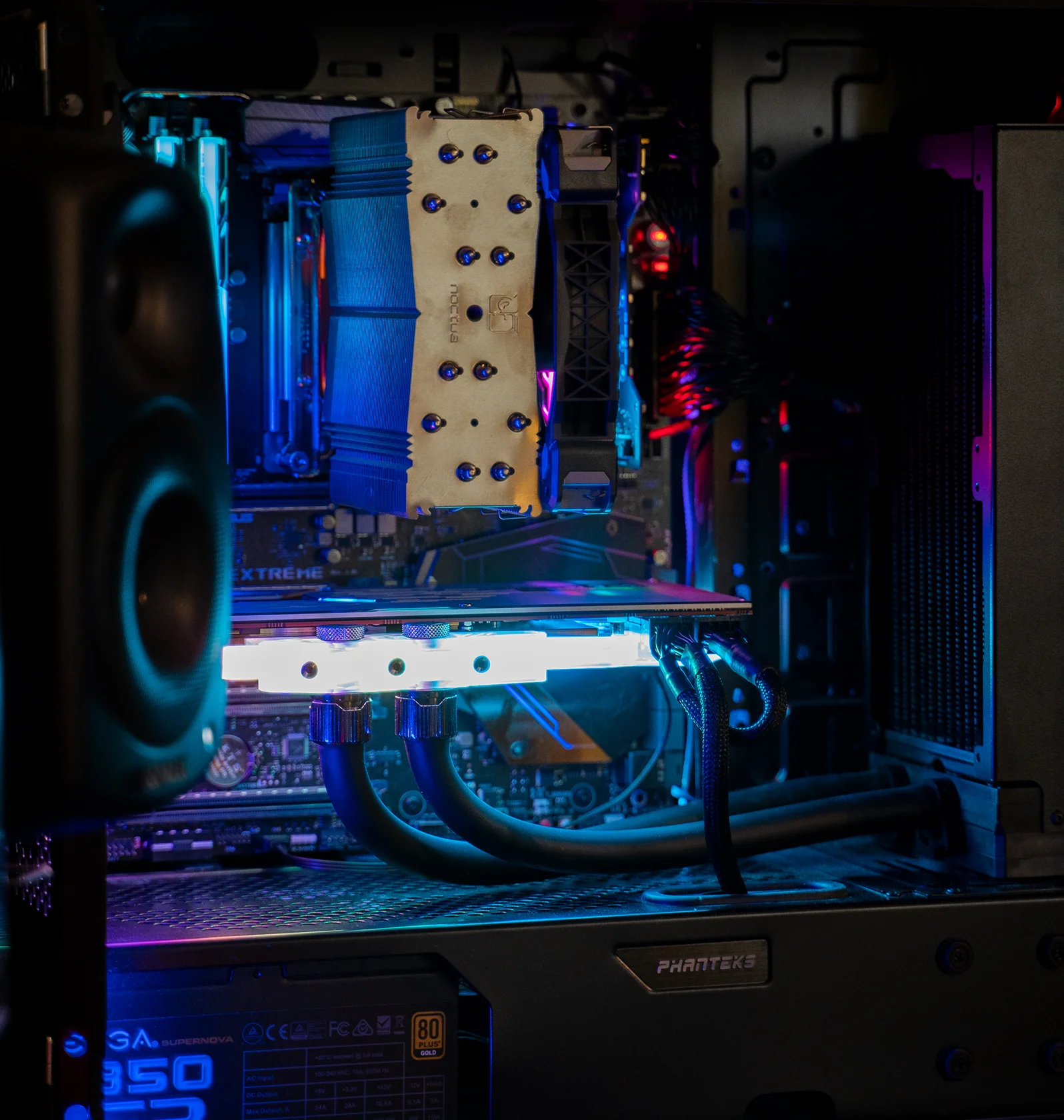

I put the Radeon VII frankenstein AIO finally together, EK MLC 240 with custom tubing + Bykski Fullcover block (used kryonaut paste), temps are amazing now, on undervolted settings with stock clocks max hotspot is now around 60-65c in heavy games (this is like 40c drop compared to stock cooler @ 50% ish fan setting), completely silent aswell, vardars are running at very low rpm. Havent tried yet overclocking, but will do when i have time.
I put the Radeon VII frankenstein AIO finally together, EK MLC 240 with custom tubing + Bykski Fullcover block (used kryonaut paste), temps are amazing now, on undervolted settings with stock clocks max hotspot is now around 60-65c in heavy games (this is like 40c drop compared to stock cooler @ 50% ish fan setting). Havent tried yet overclocking, but will do when i have time.
Nice! That's a result! Got any piccys?
