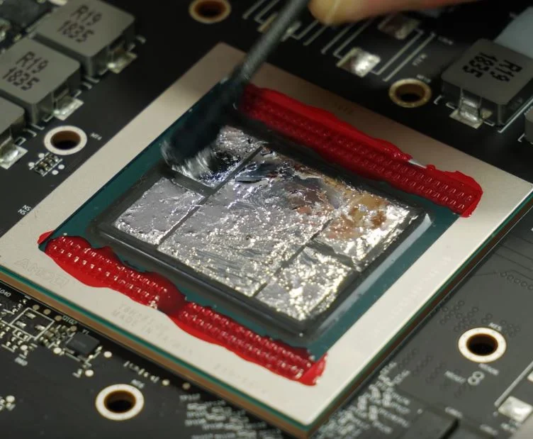

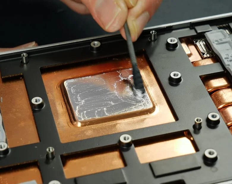

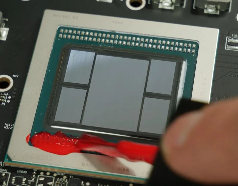

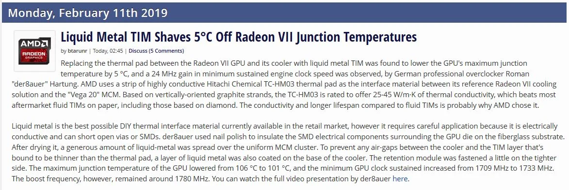

https://www.techpowerup.com/252457/liquid-metal-tim-shaves-5-c-off-radeon-vii-junction-temperatures
These are prime candidates for waterblocks. I think they'll be flipping amazing with good cooling combined with LM.
