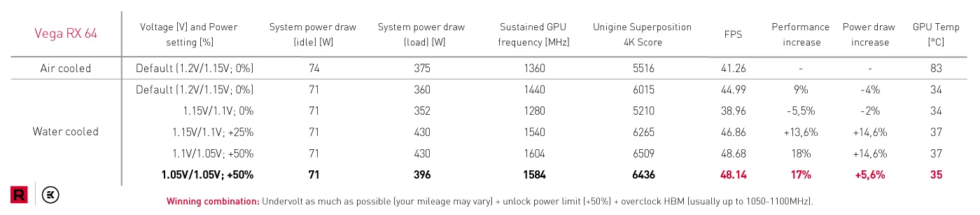

This is an interesting one and reinforces what I was talking about yesterday.
"Back in 2017, EK released a report which claimed that their RX Vega 64 offered a 9% performance boost and a 4% reduction in power draw by trading AMD's reference blower for the company's full-cover water block. Perhaps the Radeon VII would see similar benefits when liquid cooled. I guess we will just have to wait and see."
Source: https://www.overclock3d.net/news/gpu_displays/ek_teases_their_radeon_vii_full_cover_water_block/1
It isn't very clear but its saying out of the box on water it holds higher clocks and manages to save 4% on power and gain 9% more performance. That's all from the block cutting the temps in half!
Found the table of figures:
