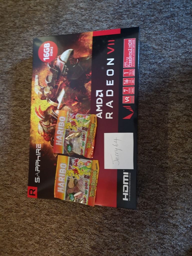

The Radeon VII Owners Thread
Look what turned up today
Not posted here in some years
Welcome and on TROH.:)

To get on the Roll of Honour all you have to do is post a pic with your user name on it of your Radeon VII.
