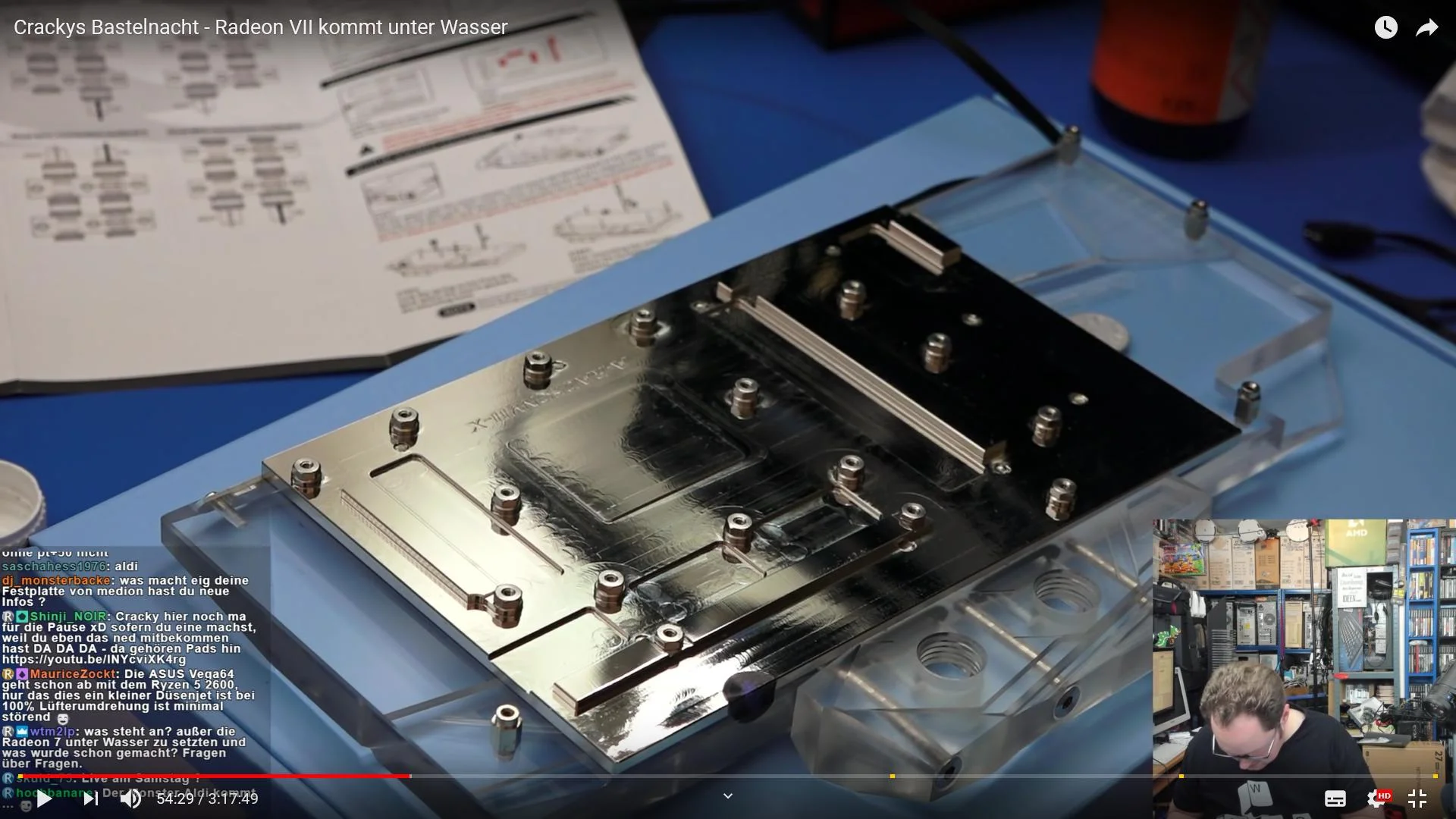

Bit of a long vid and I don't understand German but fits a new waterblock on the Rad VII with some benchmarking.
https://www.youtube.com/watch?v=2Ug8yL3Q6H8
The machining doesn't look very good at all on the die area. You can clearly see machining marks!
So the Bykski works out to what, £90-100? Uses original backplate.
Ek is £130ish? plus £40 for a backplate.
Alphacool is £115 and includes a functional backplate.
Hmmm.
The video is interesting in that he left 2 sprung screws out on the 4th row from the front of the GFX card when he was looking to fit the original back plate. have to agree that the machining looks very visible but is highlighted by the high gloss reflective coating.
have to say the temps were quite impressive even so, especially giving it 1.2mv plus! I will look closely at mine when it arrives tomorrow after paying the customs charge. but do like the idea of using the original back plate.
