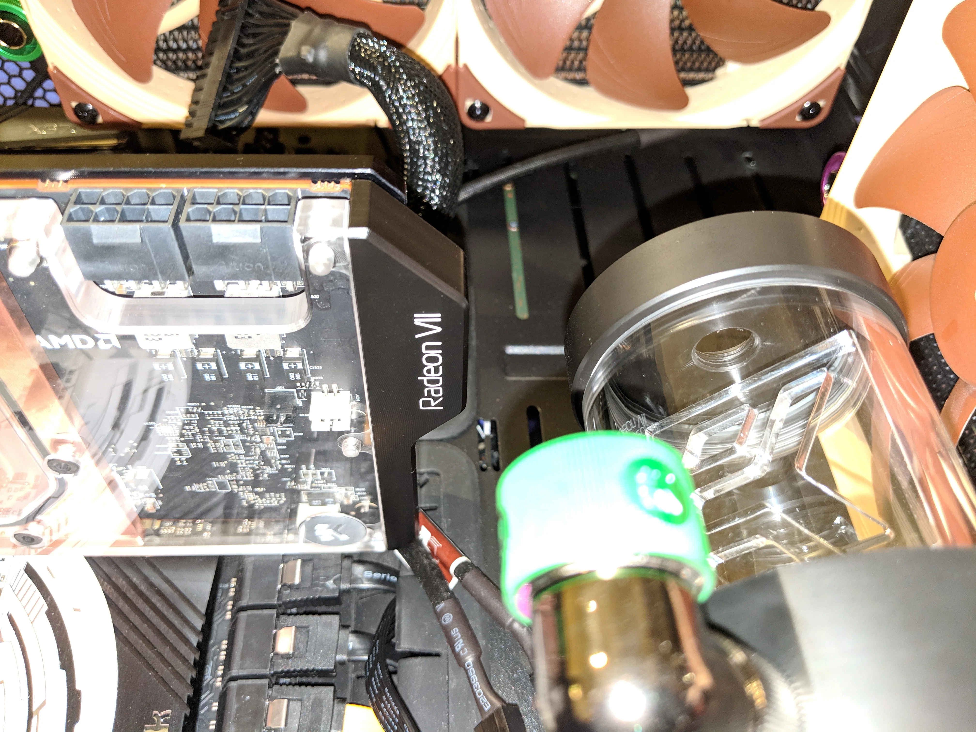

No other issues with the block aside from the tediousness of cutting the thermal pads, and disassembling the card isn't that fun, as mentioned by others the fan connector isn't fun to remove had to tease it off with a really tiny flat head screwdriver.
In other news the notch at the end of the card makes it longer than with original cooler...
So my careful measuring has gone to pot and my thick rad + fan + pump reservoir combo doesn't fit by about 5mm... Thanks EKWB!
After dinner I'm going to see if I can swap my thin rad at the top to the front instead and hope I don't have a RAM / mosfet heatsink conflict like I was trying to avoid with the thinner rad up top...

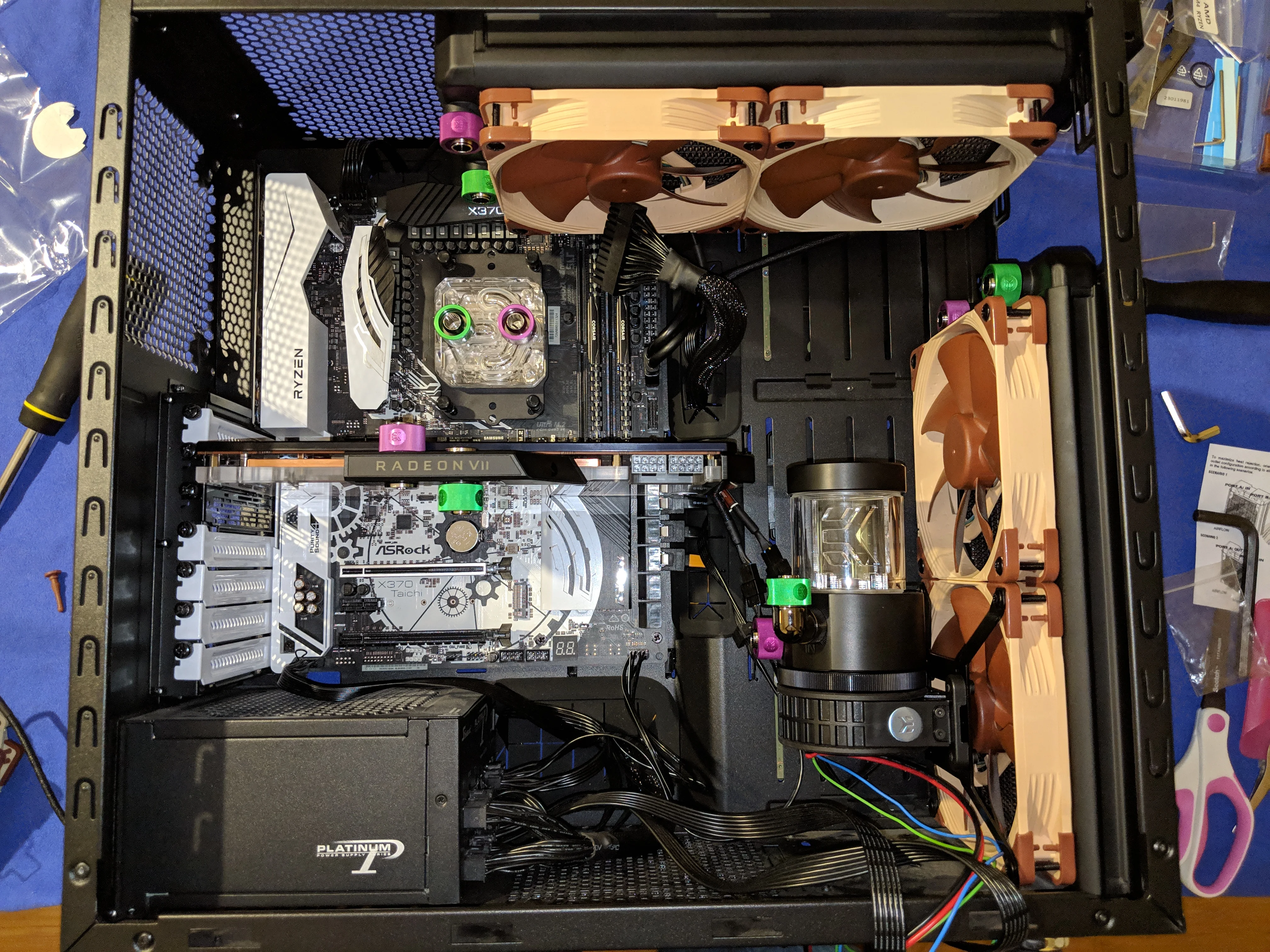

Thankfully my fat rad just fits at the top although the fan ha literally touching my RAM! If I'd gone for a 45mm EKWB radiator instead of the 54mm Hardware Labs rad then it might JUST have fit at the front... Oh well thankfully not a disaster!
Pipe work and testing tomorrow :)

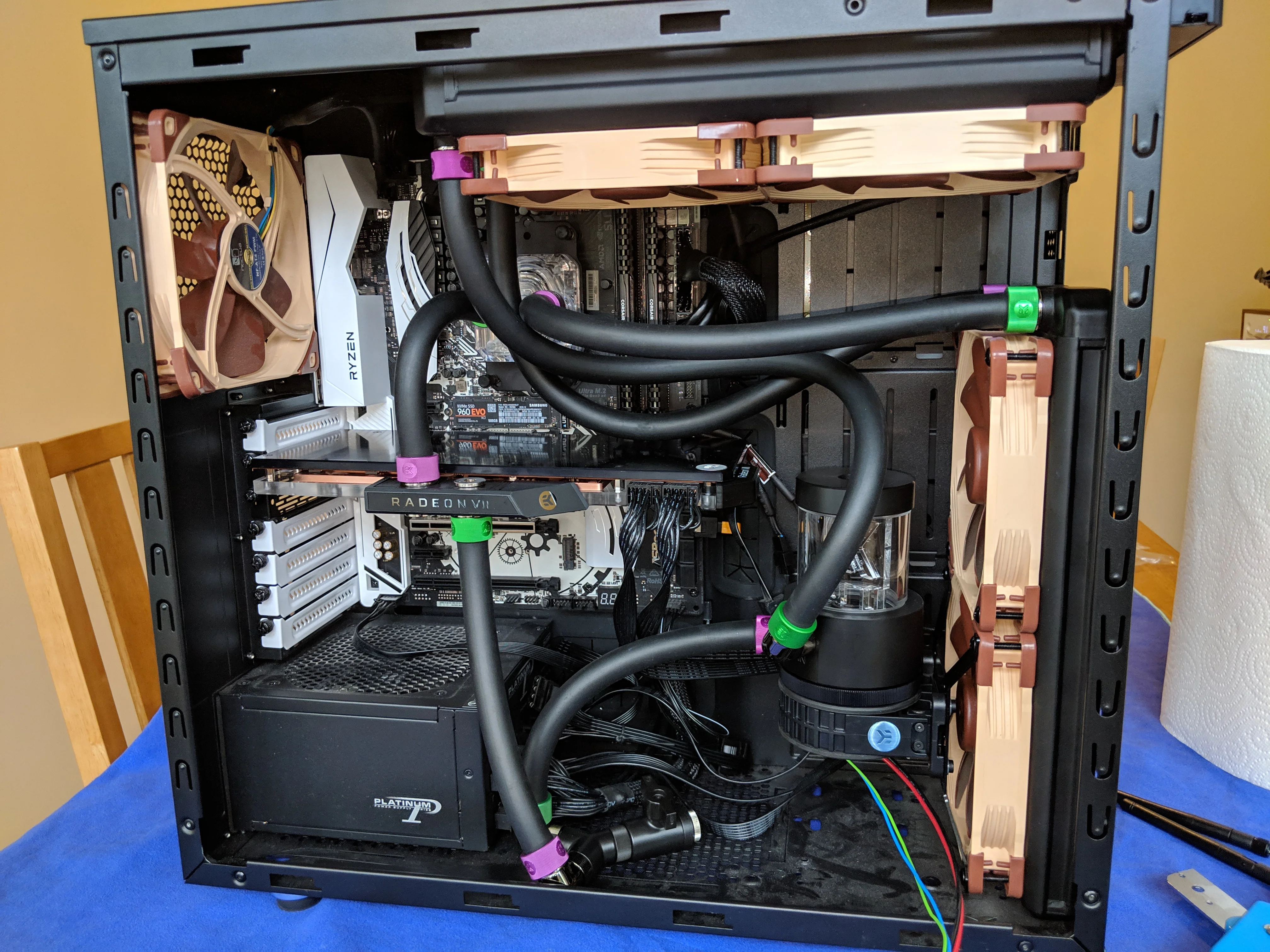

Looking very nice. Just one thing. Your front fans are pushing the air out of the front, so need to be the other way. Either side of the rad just push air into the case to then go out of the top.
Hopefully it should be fine like that because I really can't be bothered to disassemble it all now...
Really wish I'd gone for barbs instead of compression fittings, really hard to get them to tighten with this EK ZMT tube, I cannot imagine it's supposed to be that hard, got a blister on my thumb :(
About to start filling it now and then pray there are no leaks!
Looking at the pic the fittings look to be bottomed out. Can't see you having an issue there.

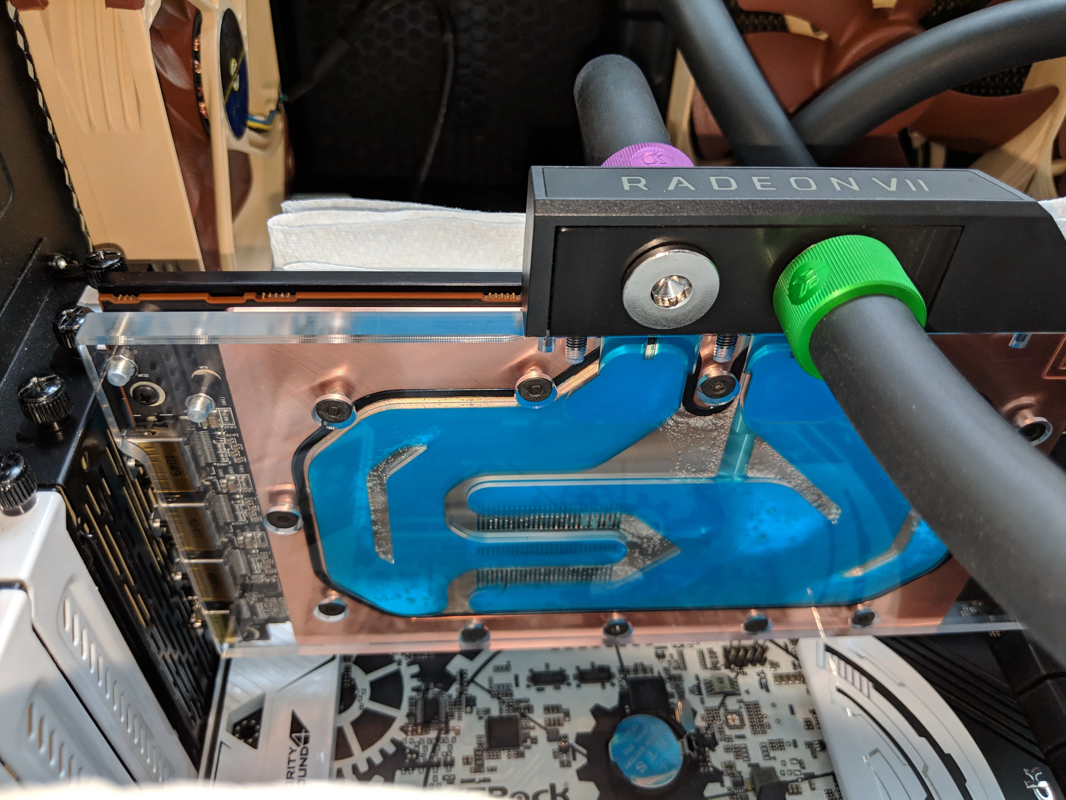

I went for EK cyrofuel, navy blue
Seems a little frothy in the reservoir at the moment, assume that will sort itself out?
Card shot below :)
Yes all the bubbles will go, you can rock the case back and forth to get all the bubbles out, you should see some nice coolant movement in your res. leave pump flat out for now.
