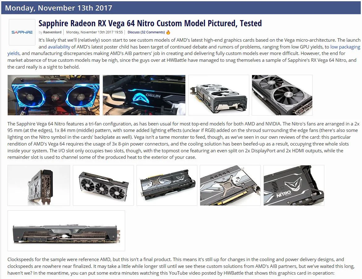

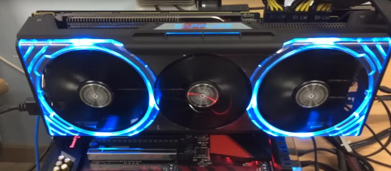

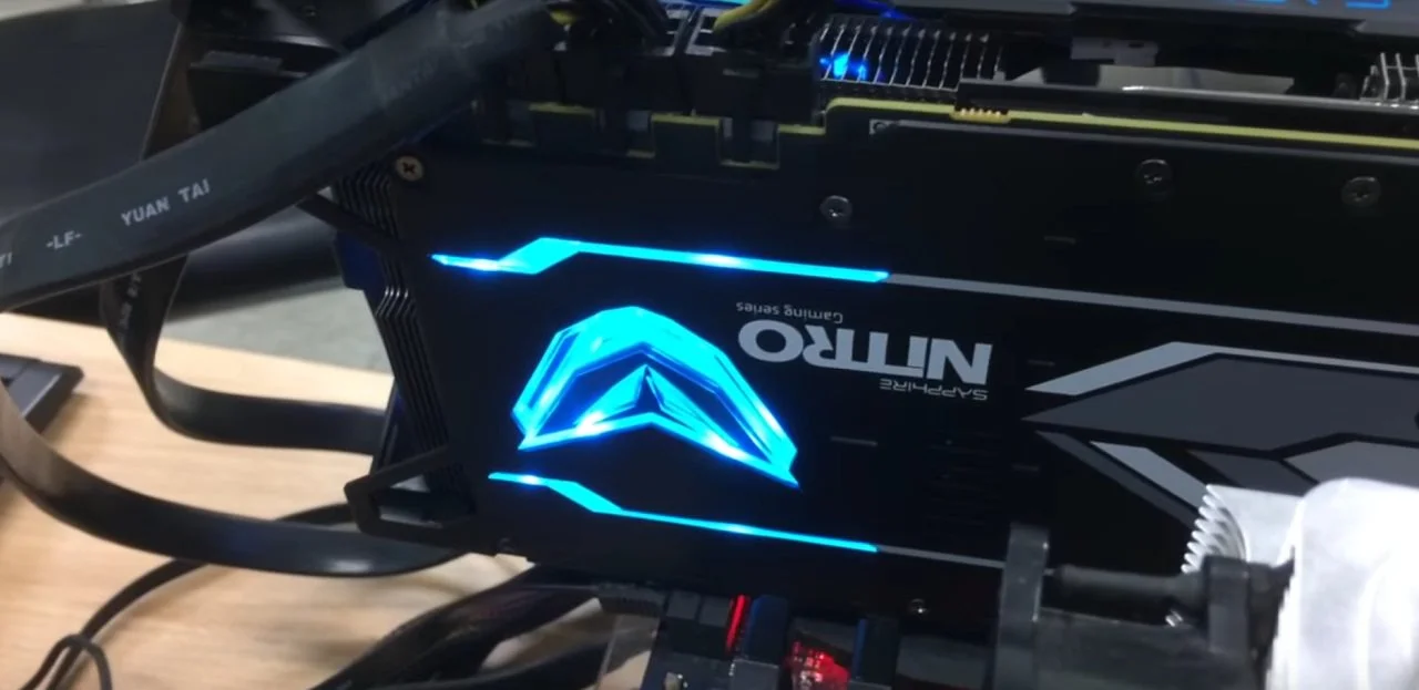

https://www.techpowerup.com/238742/sapphire-radeon-rx-vega-64-nitro-custom-model-pictured-tested
As per the bottom vid, its a 56.
