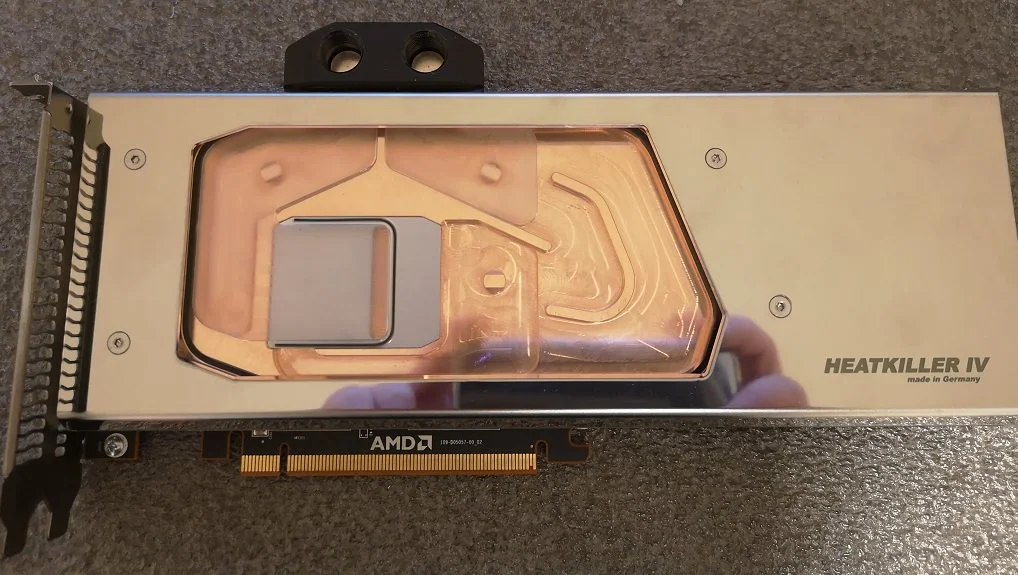

So watercooling tests with the reference card have to wait for Monday-Tuesday. Though that didn't stopped me to put the waterblock, which is really beautiful.

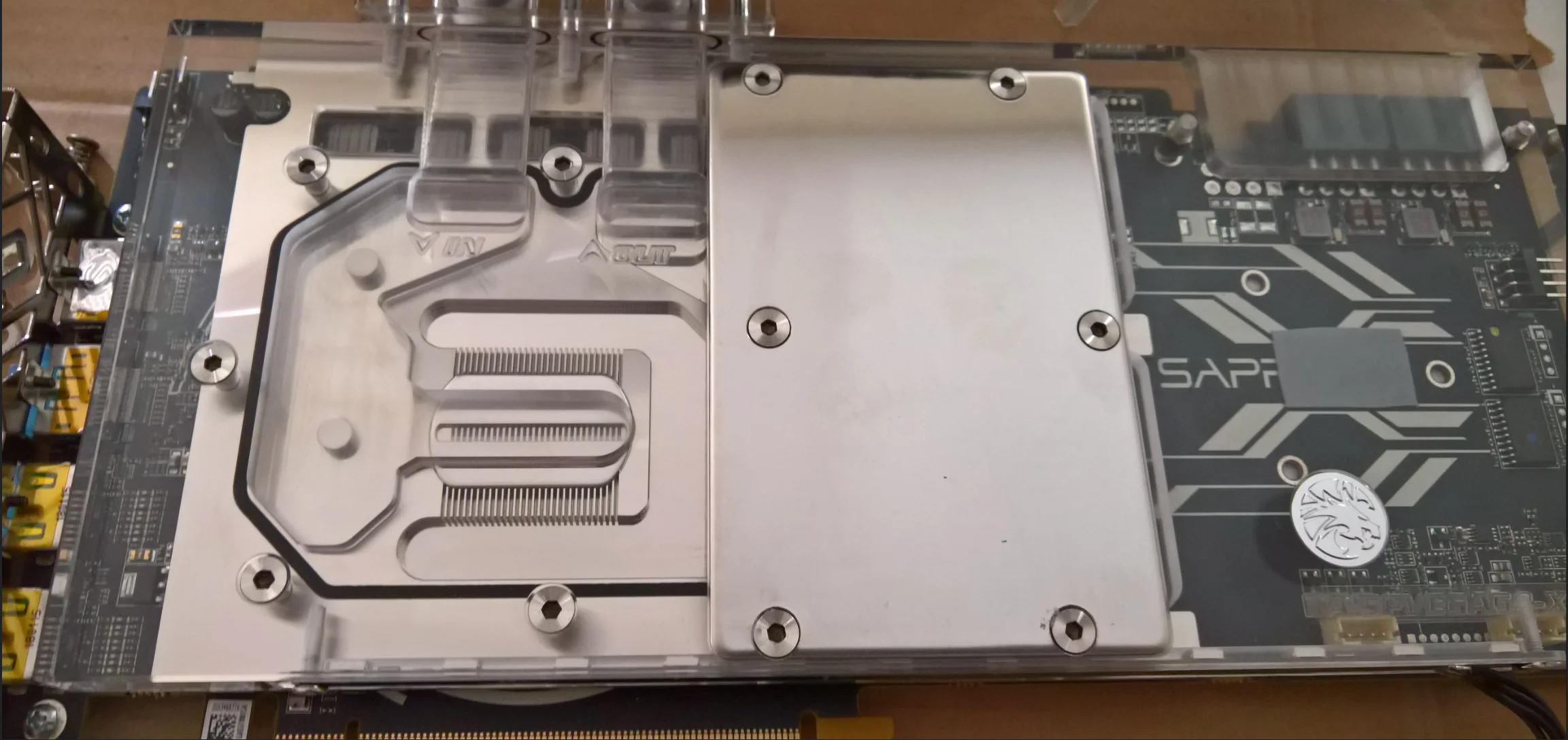

Compared to the Nitro block.
