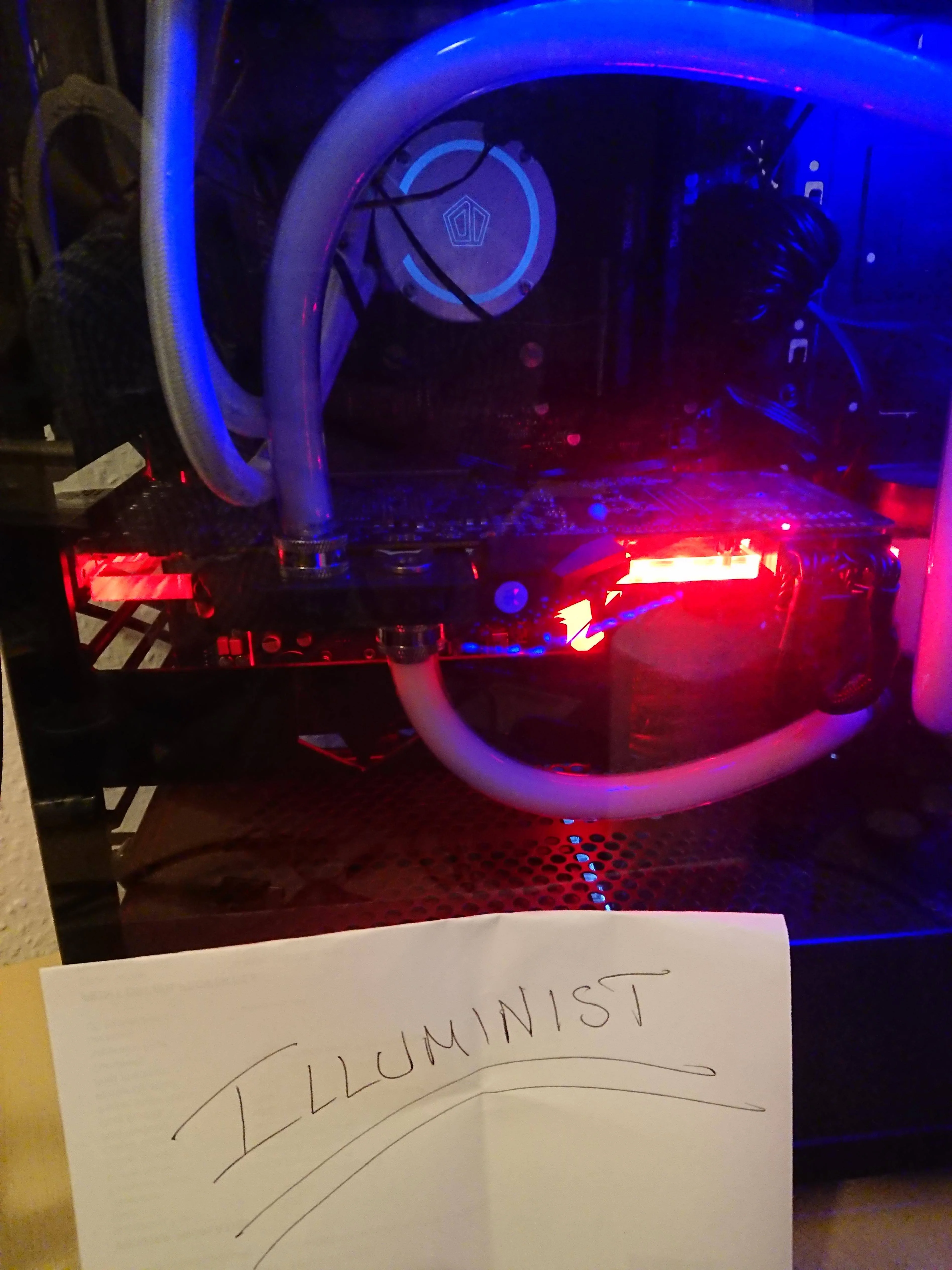

I totally forgot that i originally was on the 56 thread ROH, so here after a long time is me joining the 64 !
Which card do you have there please, I have put you on TROH as Reference Air.:)
