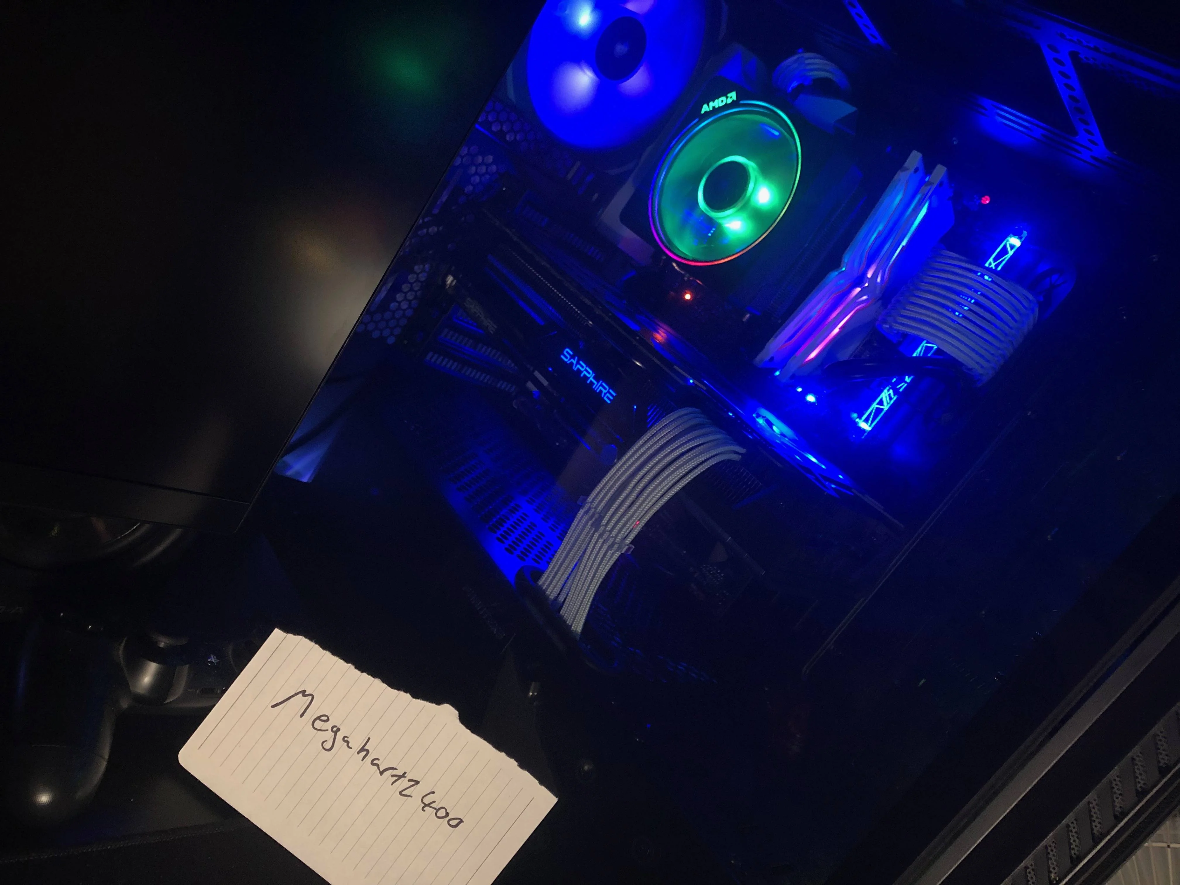

To get on the Roll of Honour all you have to do is post a pic with your user name on it of your Vega 64.
