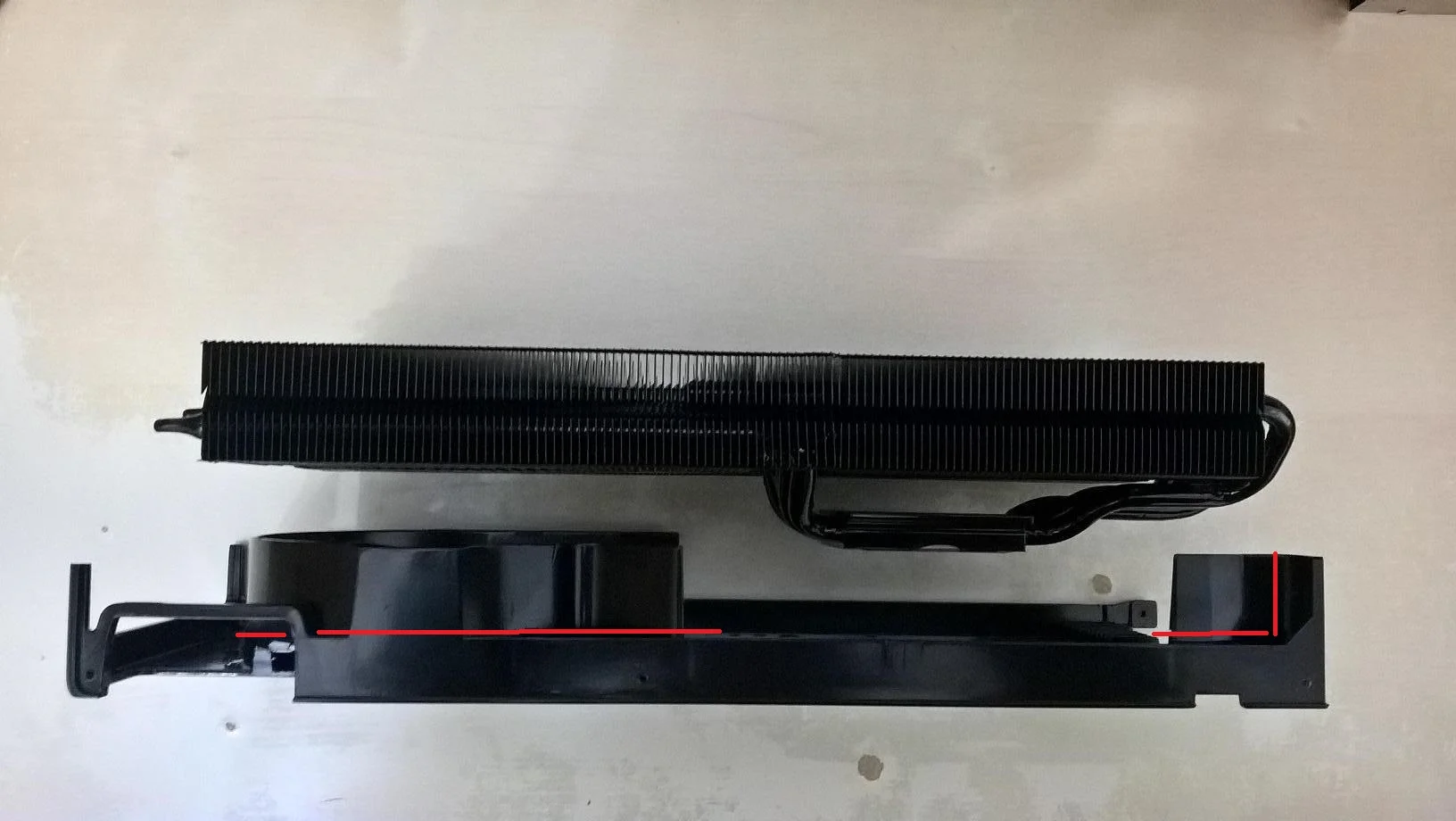

Did the Morpheus II mod for my Vega 64 but wasn't too happy with the VRM temperatures. They were getting over 100C when running stress tests or extended gaming sessions. The little heatsinks weren't cutting it so I decided to cut up the stock front plate and do that mod.
Took about 30 minutes with the Dremel, and a lot of store brand cutting discs breaking but I got a relatively clean cut. VRM temps now only get to about 90C at most after running stress tests. I could probably get it lower if I changed the thermal pads on the front plate but at this point I don't want to open up the whole thing again. Card also definitely feels more rigid with the stock front plate and back plate on now.
Only issue now is that the coil whine has somehow got even louder after doing the front plate mod. Before it wasn't too audible but now i can hear it buzzing from across the room when the card is under load.
Did you do it to he reference 64 card? Any pics, or links how to do the mod?
Sadly I didn't take any pics but I used some guides I found on Reddit. There are some pictures a person posted of their mod they did to their Vega 56 although this person didn't add the backplate
https://imgur.com/gallery/2JVRt
First, after taking the reference cooler apart you basically want to cut the curved bit where the reference blower fan sits in order to make clearance for the Morpheus heatsink. I found this picture and drew red lines where you have to make the cuts (for the curved bit you have to cut all the way around). I cut mine so that it would be flush with the lip of the front plate. Best tool would be something like a Dremel or similar Rotary tool with some good quality cutting discs. If you are planning on reusing the stock heat pads then I would suggest placing some painters tape over them so that the metal dust doesn't get stuck to them.
Second, you have to enlarge the four holes on the stock front plate so that the mounting standoffs on the Morpheus will pass through the front plate.

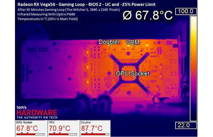

If you wish to reuse the stock backplate you will have to reuse the stock X bracket as the Morpheus X bracket won't fit in the stock backplate. Take the screws out of the stock X bracket and use the spring screws from the Morpheus to screw in the stock X bracket to the cooler. Just be very careful with the pressure as you don't want to crack your GPU die, though the screws should stop. Use the cross pattern when tightening.
I added some thermal pads to certain chips on the back of the card so that they would make contact with the backplate. There was a thermal image of a card that showed six spots on the back that got really hot and I put thermal pads on those (the six yellow spots on the back of the PCB shown below).

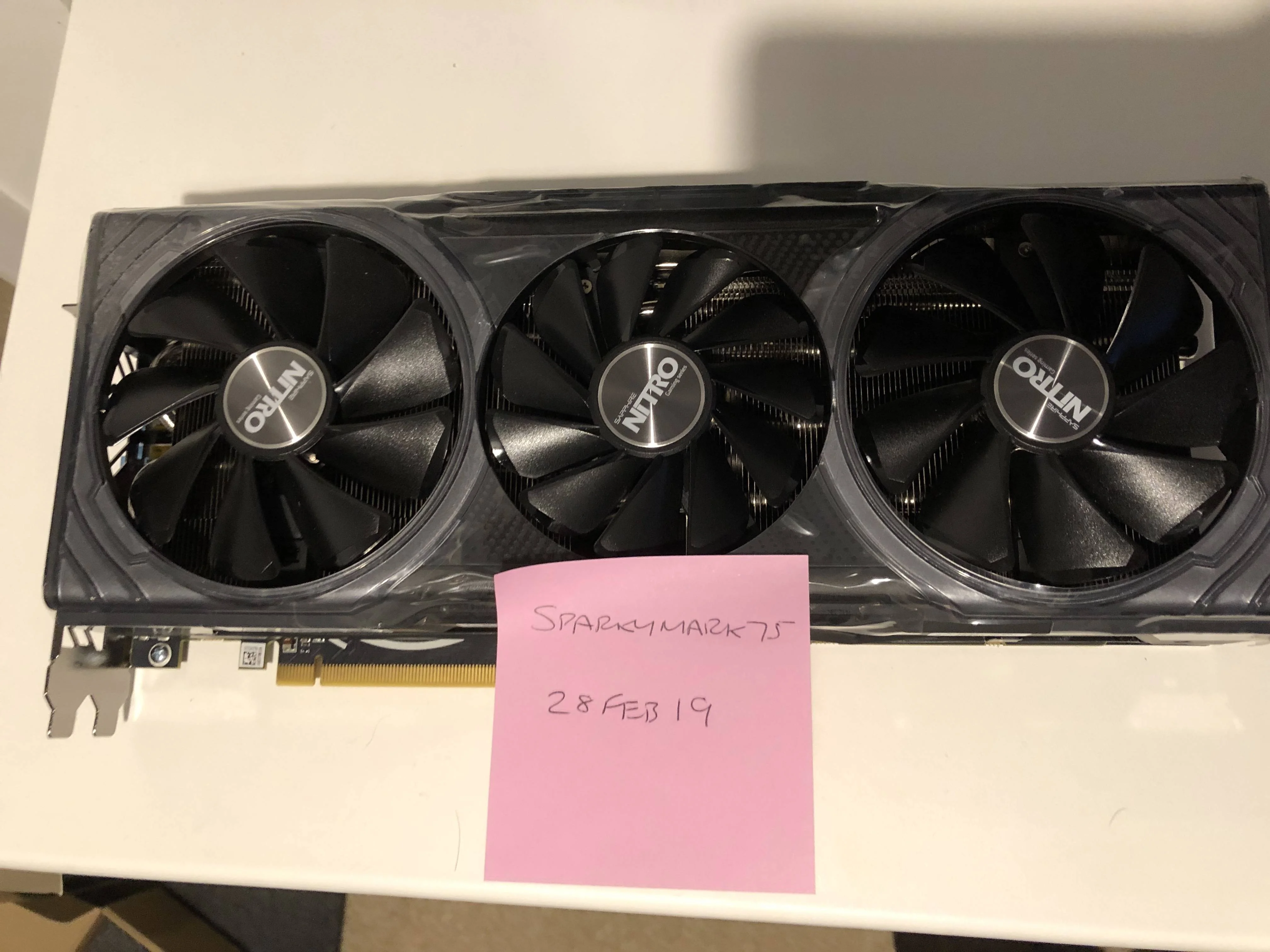

Late to the party, in fact so late, everyone that was hammered is sobering up and people are stumbling their way out the door. Anyway, here I am....
Now for some tinkering!
Welcome and on TROH.:)
