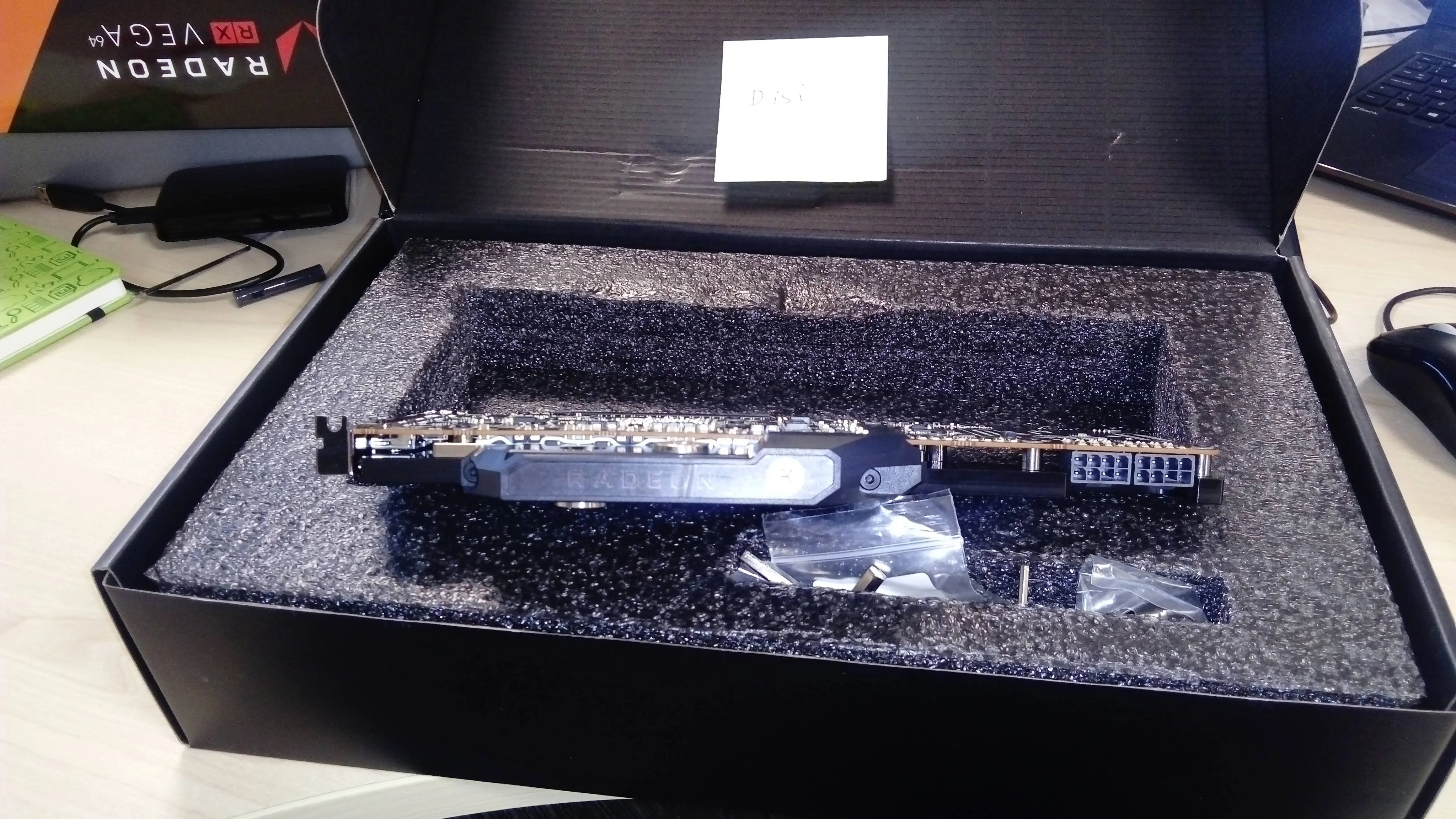

So, I finally got them smuggled in and fitted without attracting too much attention!
Just waiting for Crossfire to be enabled now! I think some serious undervolting will be required!
Please can I get on TROH?
Cheers :D

Welcome and on TROH.:)

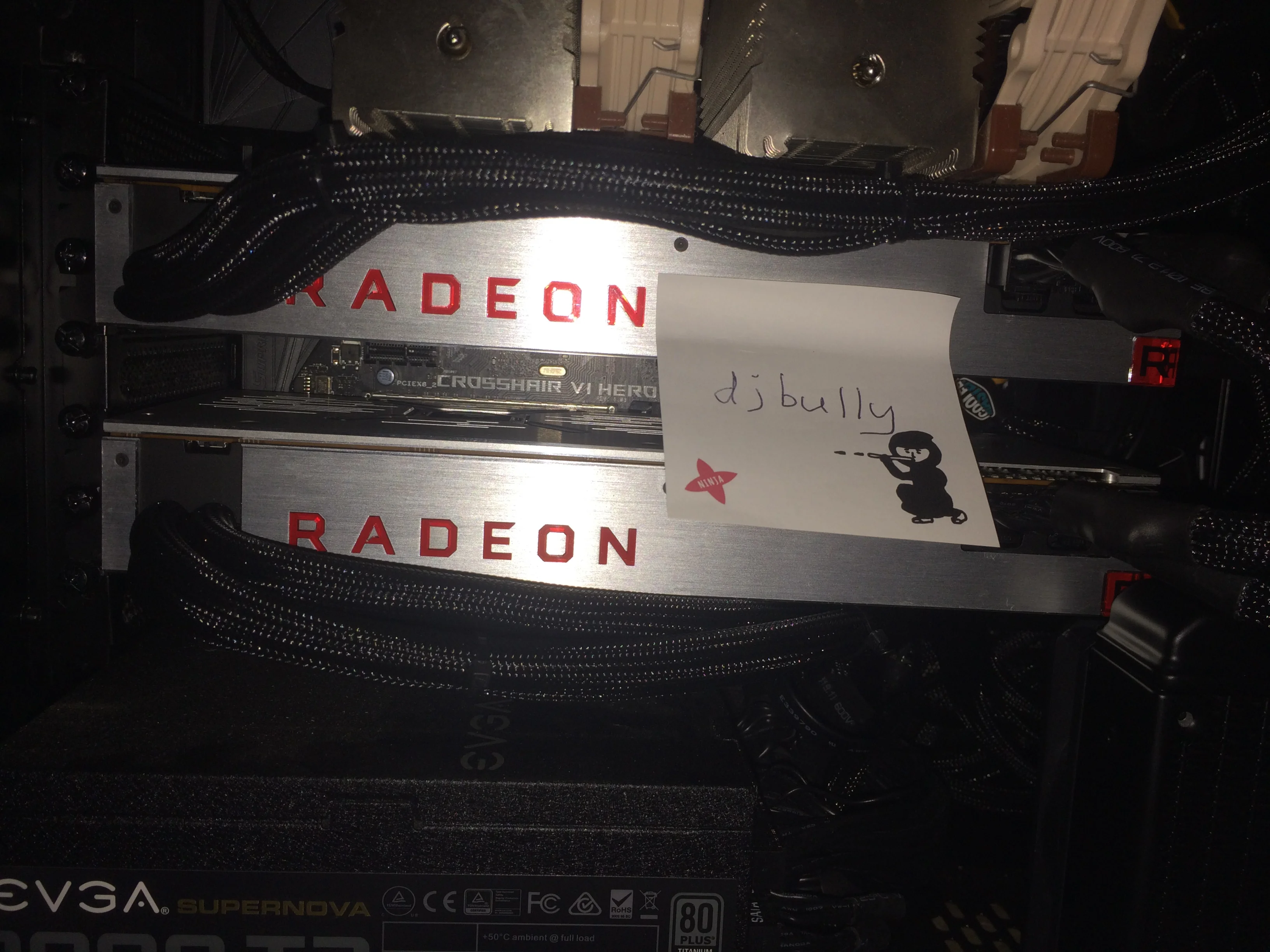

{snip}
Cheers :D
Wow - MOAR POWA!!!11!!one!!!!!

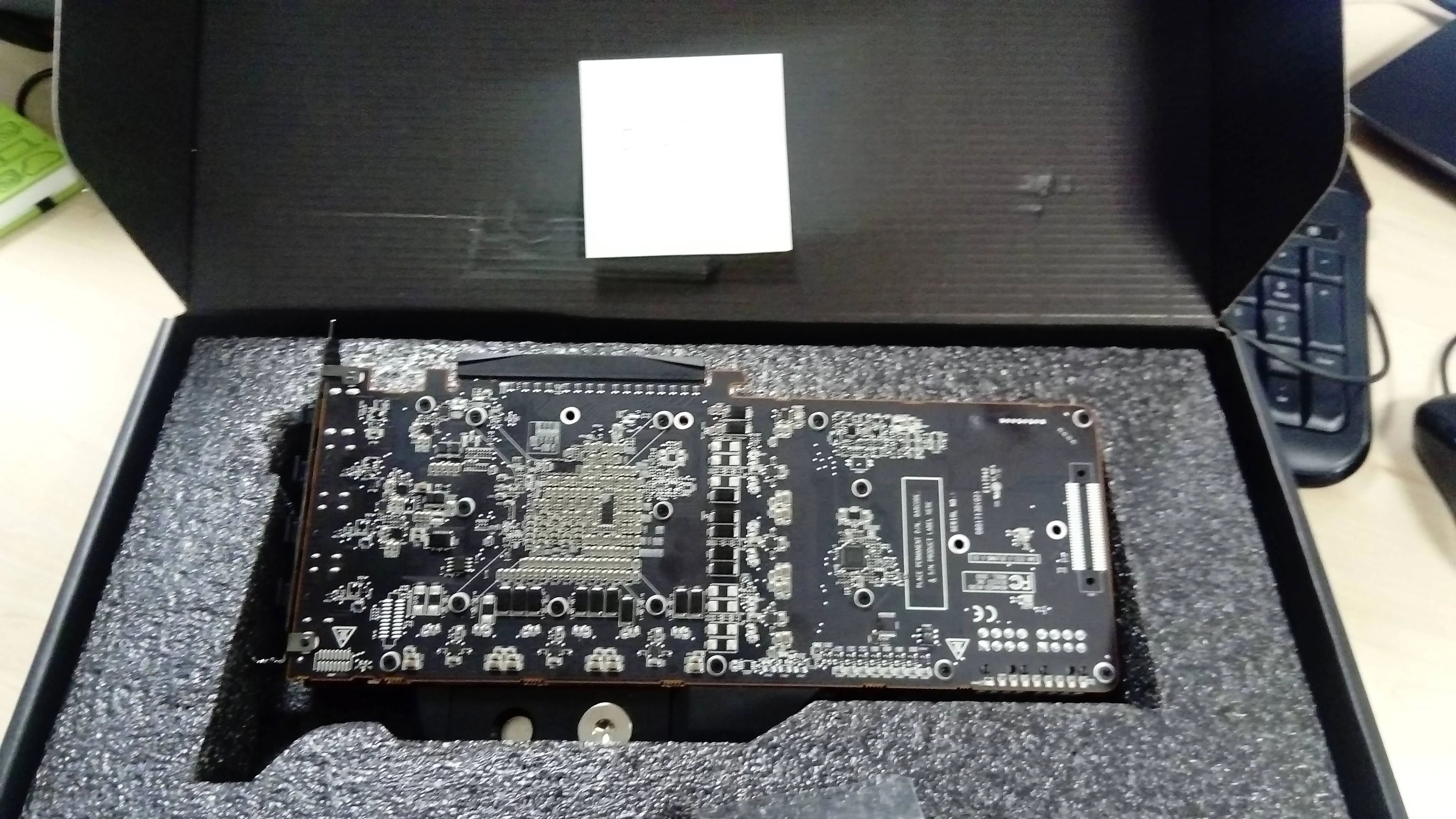

Do we need to unwrap it?
Now I want a backplate :(

Backplate is the way to go for watercooling + single slot bracket looks very neat and tidy.:)
