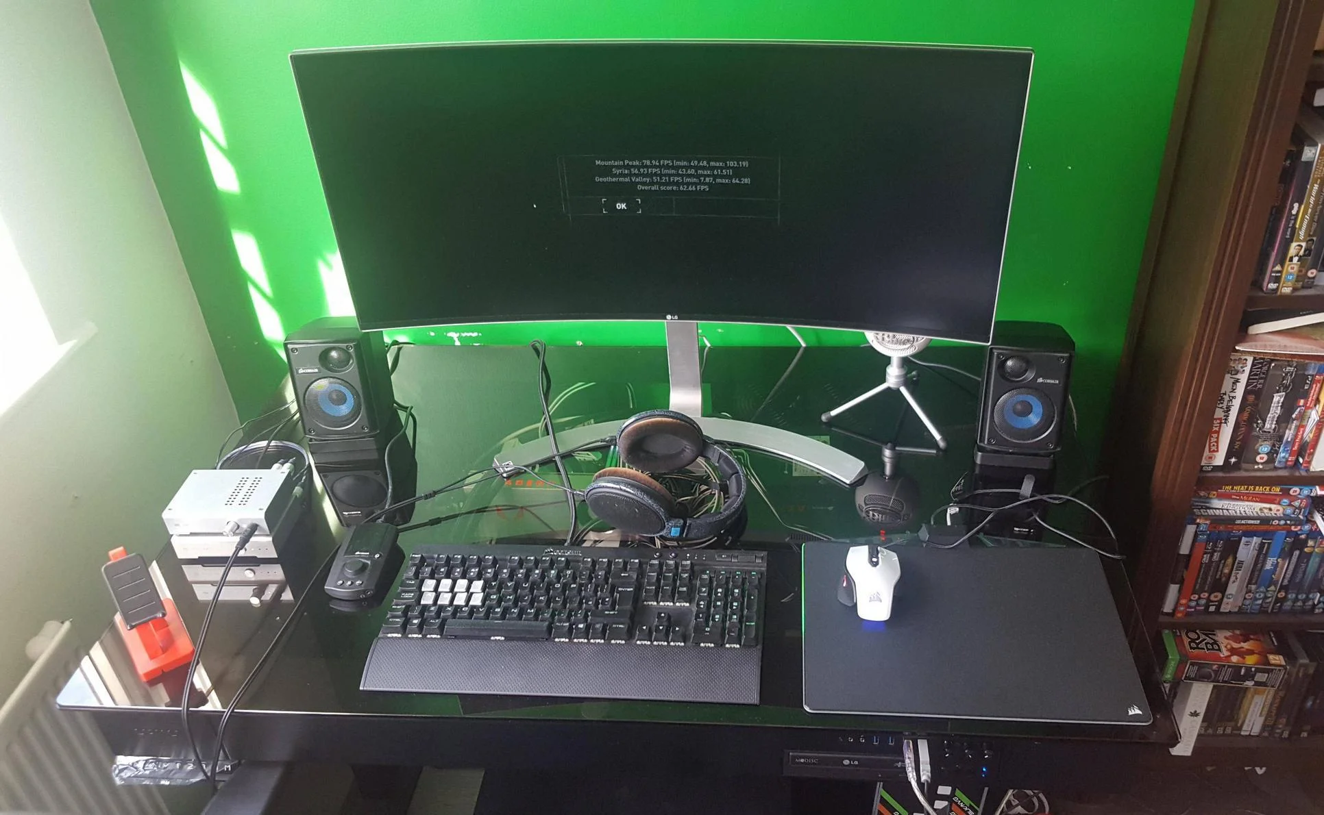

Apologies, I forgot to put my name in the pic because I snapped it quick for a reddit post lol
Had this actually day 1 but been away, the DK04X from Lian Li, the mouse and the mousemat are new too ;)
Sexy? Even sexier when I watercool it!
Nice :cool:
The only thing i don't like, is that Nvidia Green wall, eww :p
