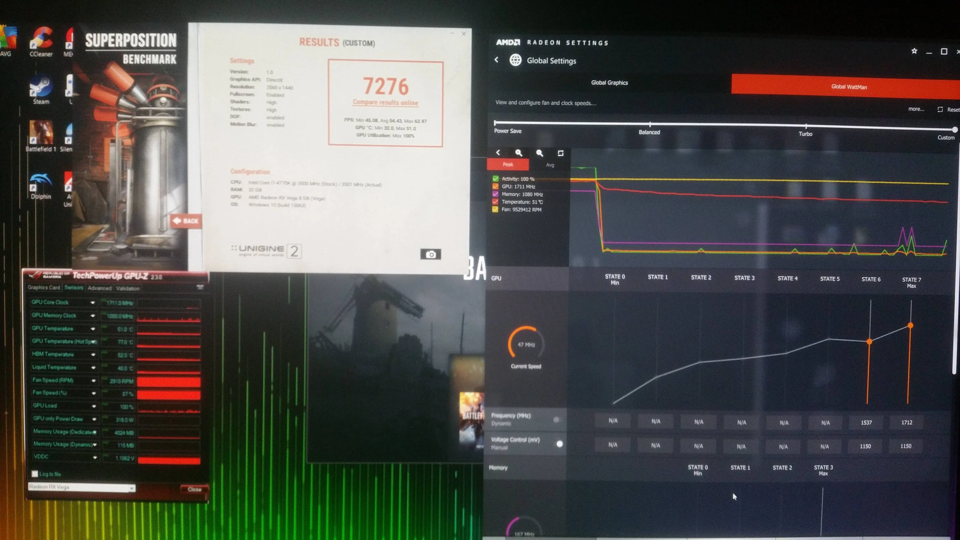

I just did the same on my liquid but at 50% power limit.
Ran a superposition benchmark at high settings and it was super smooth.
Looks like it wasn't stable at these settings.
Jumped on sniper elite 4 straight after and it black screened crashed on me within 15mins at a GPU hungry cut scene. (This is with VSR set at 3k instead of 2560 x 1440 though.)
Back on standard clocks/voltage and BF1 ran fine at the Same VSR for another 1hr until I shut down.
Will try default voltage and 1080 memory clock next.
