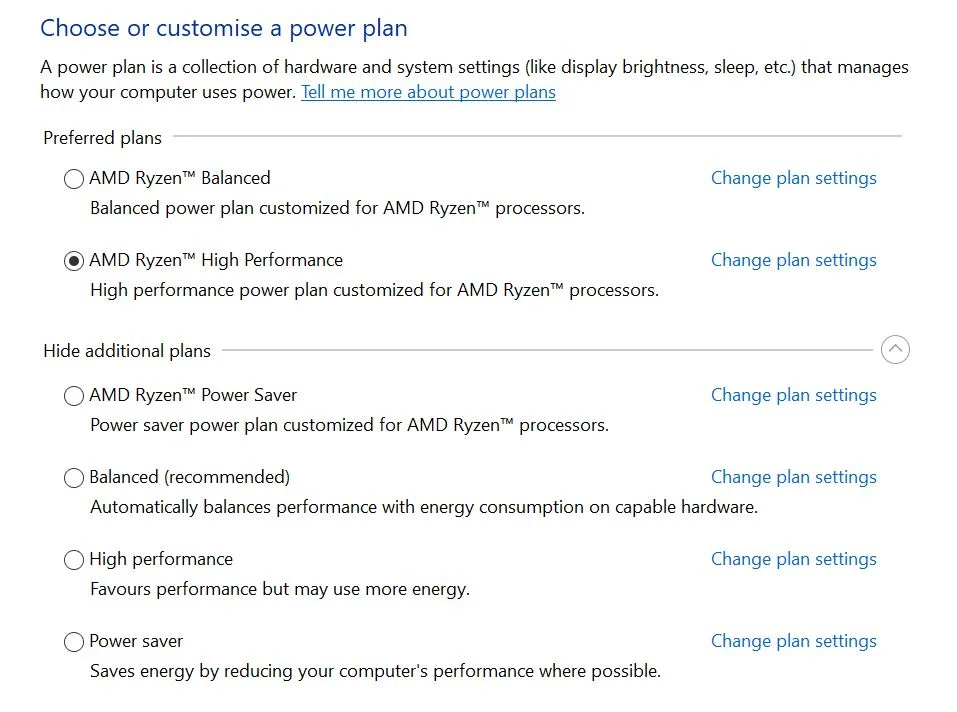

How do you get more options with the power plan, because at the moment mine is on balanced.
8 Nov 2006
22,979
London

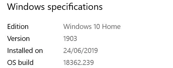

What version if Windows you on?
I'm assuming its either that or the latest chipset drivers.
I've never actually deliberately set it to this. I had previously selected Windows High Performance. Only noticed the new Ryzen ones today and it must have switched automatically at some point.
Ah i see yea i have not updated in a while, will update now.
