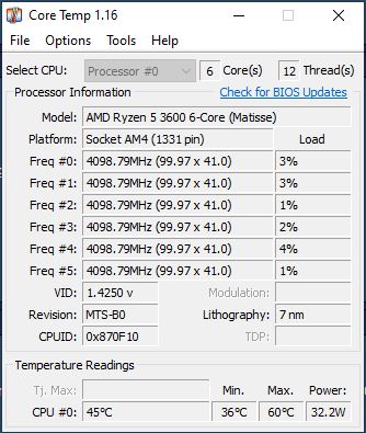

Hey guys,
I have a Ryzen 5 3600 on a Coolermaster 212 Black RGB. My room temp is around 25 C right now and it's in a Fractal Design S case. My MB is a AsRock B550M Pro4.
I'm seeing high idle temps - using HWMonitor I see the following:
- Idle around 40-50C (I see lots of spikes but I hear that's normal?)
- Max 68C after some gaming on BF4
- Lowest 36C
https://imgur.com/Vc70ZKg - here's an image right now.
Questions:
1) I tightened the screws on the cooler, does'nt seem to have made much difference. I put the cooler on correctly with the right amount of thermal paste but I've just ordered some Artic Silver 5 to re-seat the cooler
2) I read some stuff about undervolting but I'm clueless - should I try to do that? Is there any easy guides where they just tell you what voltage to use?
Thanks

Max 68C with 25C ambient is fine. If you really want cooler temps you'll likely have to set a more aggressive fan profile. The 212 is low end cooler but easily good enough for the 3600.
If you are clueless don't bother touching any of the settings.
AS5 is unlikely to change the temps by more than a degree or two.
