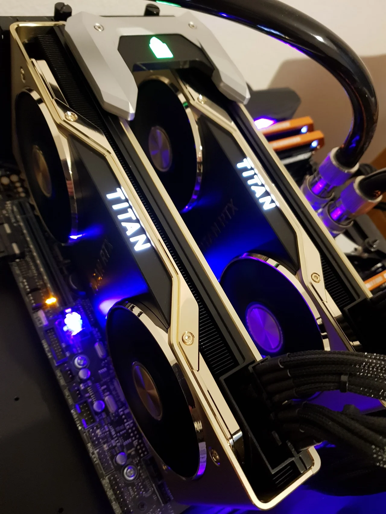

Beautiful pics of your cards Kaapstad.
Thanks.:)

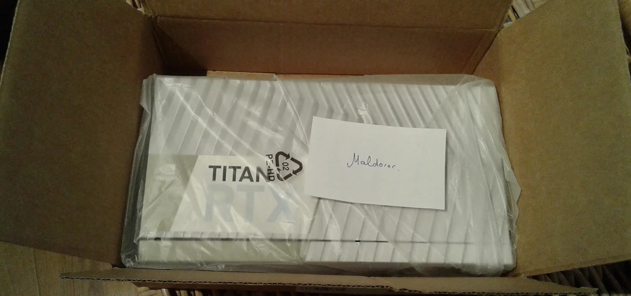

Date 22/12/2018, Make NVidia Reference, Maldoror, Link

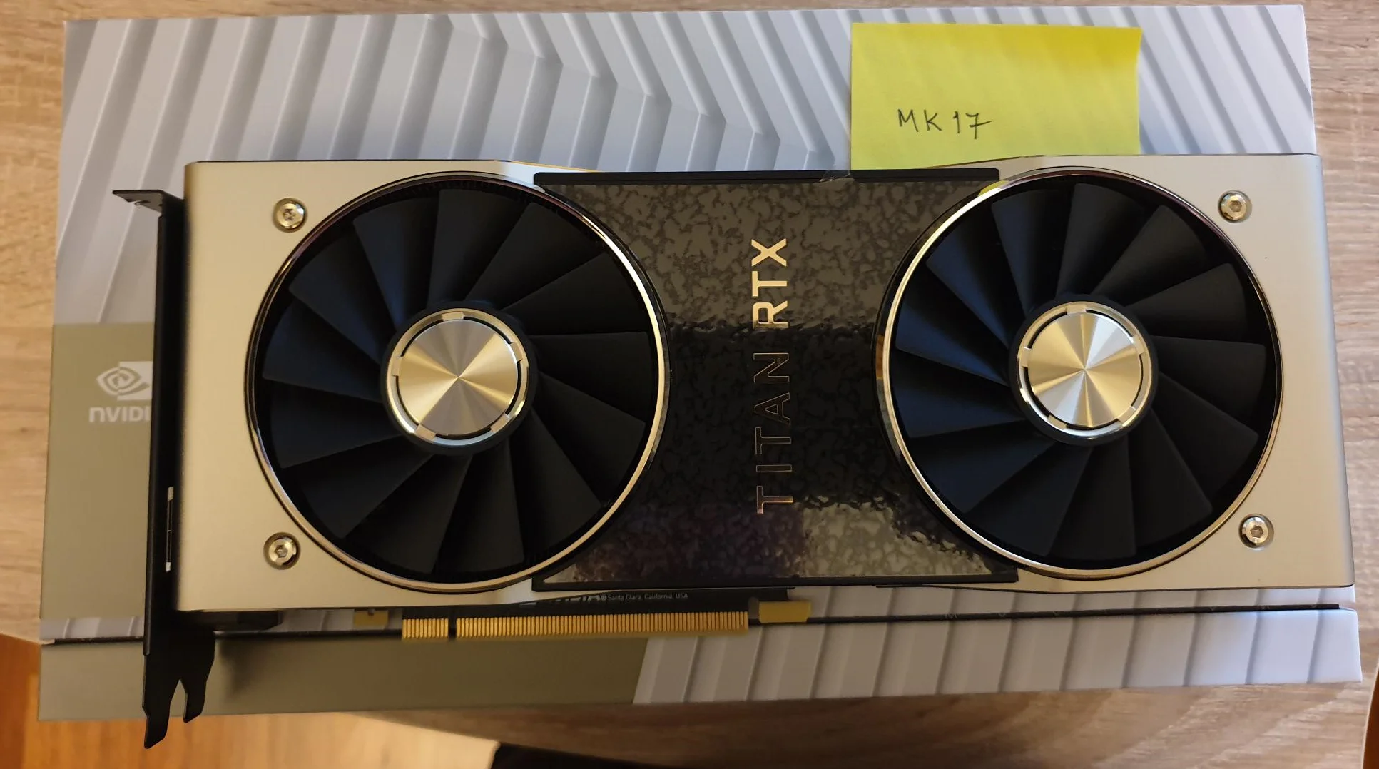

Date 22/12/2018, Make NVidia Reference, mk17, Link
Date 20/12/2018, Make NVidia Reference, Kaapstad, Link
To get on the Roll of Honour all you have to do is post a pic with your user name on it of your RTX Titan.
