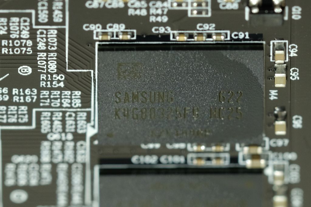

Bored waiting for bits and pieces to arrive for a new build, had a go at fitting an EK waterblock to a Gigabyte 1070 G1 Gaming gpu. Basically, the generic thermal pads will have a lowish thermal transfer rate. Can't find the link here to a cool build which used Fujipoly pads over the stock pads to improve cooling. The fuji pads come in 3 flavours, 11,14, and 17W/MK.
Availability and price put me off, so looking about, came across the new Gelid GP extreme pads rated at 12 W/MK. 1 small sheet of .5mm and 1.0 mm, are both 80mmx40mm. It was enough to do the job. Cutting with a scalpel was easy, but application was tricky. The pad is like a piece of plasticine sandwiched between 2 sheets of plastic film. Its the removal of film that you need to be careful with. Board and waterblock now assembled. I have no idea how this will perform over the stock EK pads. Just thought I would put it out there.
And I won't be doing a before and after comparison, unless something goes wrong. I dare say there will be someone who can do a meaninful review/comparison. Hope it does the job.

Yes, it was you! Got the 2 Gelid pads for £15 which was a bit easier on the wallet. Removing the original ek pads I did notice some moist residue traces left on the chips. Whether its an impregnant within the pad material or an application of thermal compound, I couldn't say. Down the line I could see EK offering a 'Plus Pad' variant on the blocks for a few dollars more.
It's safe moisture, it's from within the pads and the same on all the stock coolers I've removed. Normally give the chips a clean anyway so it's not a problem. I used the pricey pads on the backplate also which was not really necessary but there you go :)
I might just copycat you with the exotic pads on the backplate. There were no pads fitted originally here, just the plate as a support and cosmetic. Guru 3D even provided a thermograph of my 1070, highlighting hotspots. A bit of extra passive cooling can't do any harm.
