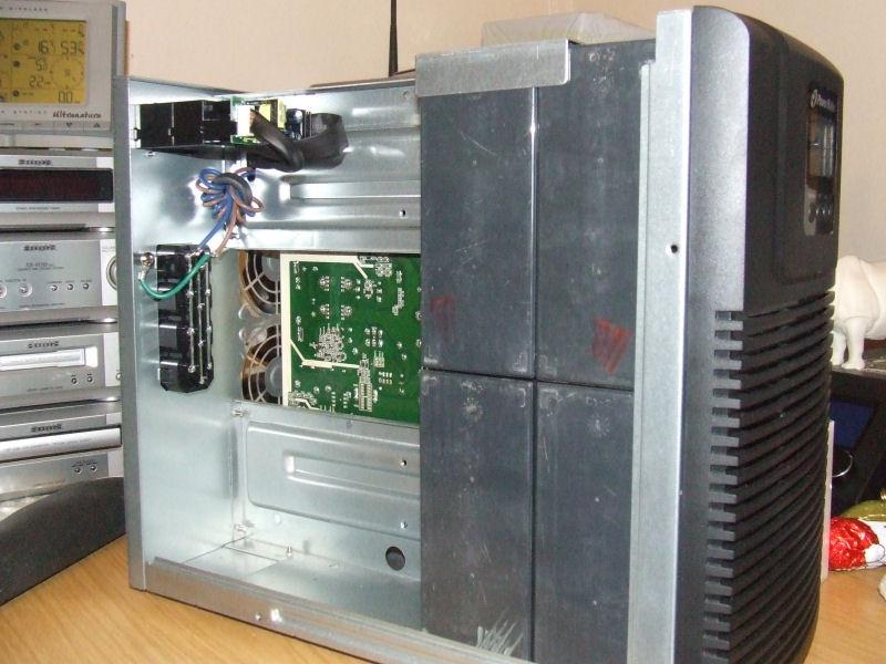

Well apparently the battery is quite easy to change and with the UPS being plastic you have less chance of shorting the dam thing... Yeah its not a 10second job but it looks much easier then my £350 1800watt UPS to change that batteries that Ive just done btw
My PowerWalker 1800watt online UPS...... The 2 compartments are cool, 1 half contains the batteries as you can see in the pic and the other contains all the electrics. But the metal case doesnt help and the batt terminals face inside the case, so the batts are a real pain to connect when you cant really see or get to the terminals easy.
