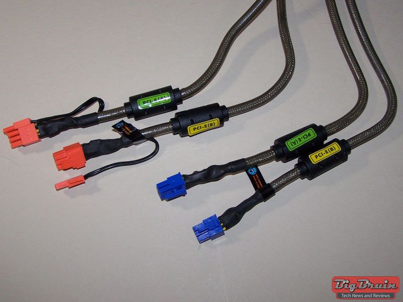

It seems that it will take the load. It's got 6x20A that can combine into a single 95A rail. I don't know how it will handle dual 580, but looks OK for power distribution.
Each Phantom 3GB requires 1x6pin + 1x8pin PCIE connector each, so a total of 2x6 + 2x8 PCIE power connectors, which the Tagan can supply. So it looks all right. It looks like you will be using the red and blue PCIE connectors, with REMI ferrite cores for the GPUs.
If you choose a different graphics card, I would make sure it won't take 2x8pin PCIE connectors. then, I would be very wary of using a molex or 6->8pin converter. Not on that kind of hardware!
Can't say about reliability or quality of the PSU itself, otherwise. But I still think if you can afford 2 phantom 3GB, then you can afford a top PSU.
My PSU is the Tagan TG1300-U33.
I have been using it for more than a year with no problems.
Can you please tell me whether i will need to get another one or if the one i have has any problems.
Tagan are a quality PSU manufacturer. They aren't as popular lately though for some reason. Maybe they aren't so good these days? I'd ignore the naysayers though, unless there are bad reviews.
Finding reviews on them is difficult, although the one I posted doesn't look bad. As long as the connectivity and power distribution stands, and the build quality is decent (which it seems to be), then I don't see why not.
