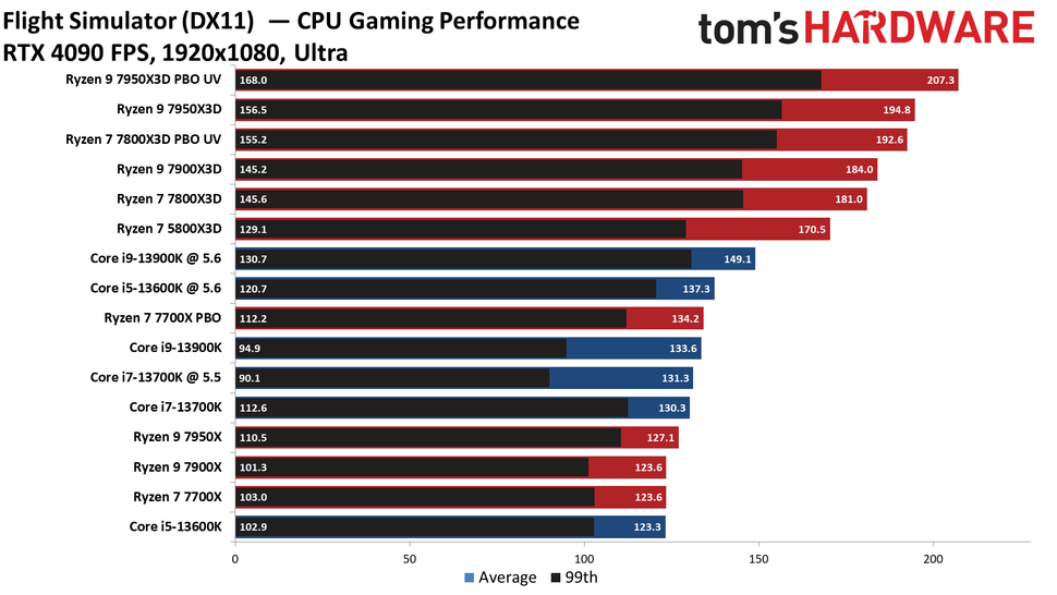

you will also find that for MSFS, the 5800x3d absolutely canes any other chip except the ryzen 7000x3d chips
see: https://www.tomshardware.com/reviews/amd-ryzen-7-7800x3d-cpu-review/4
