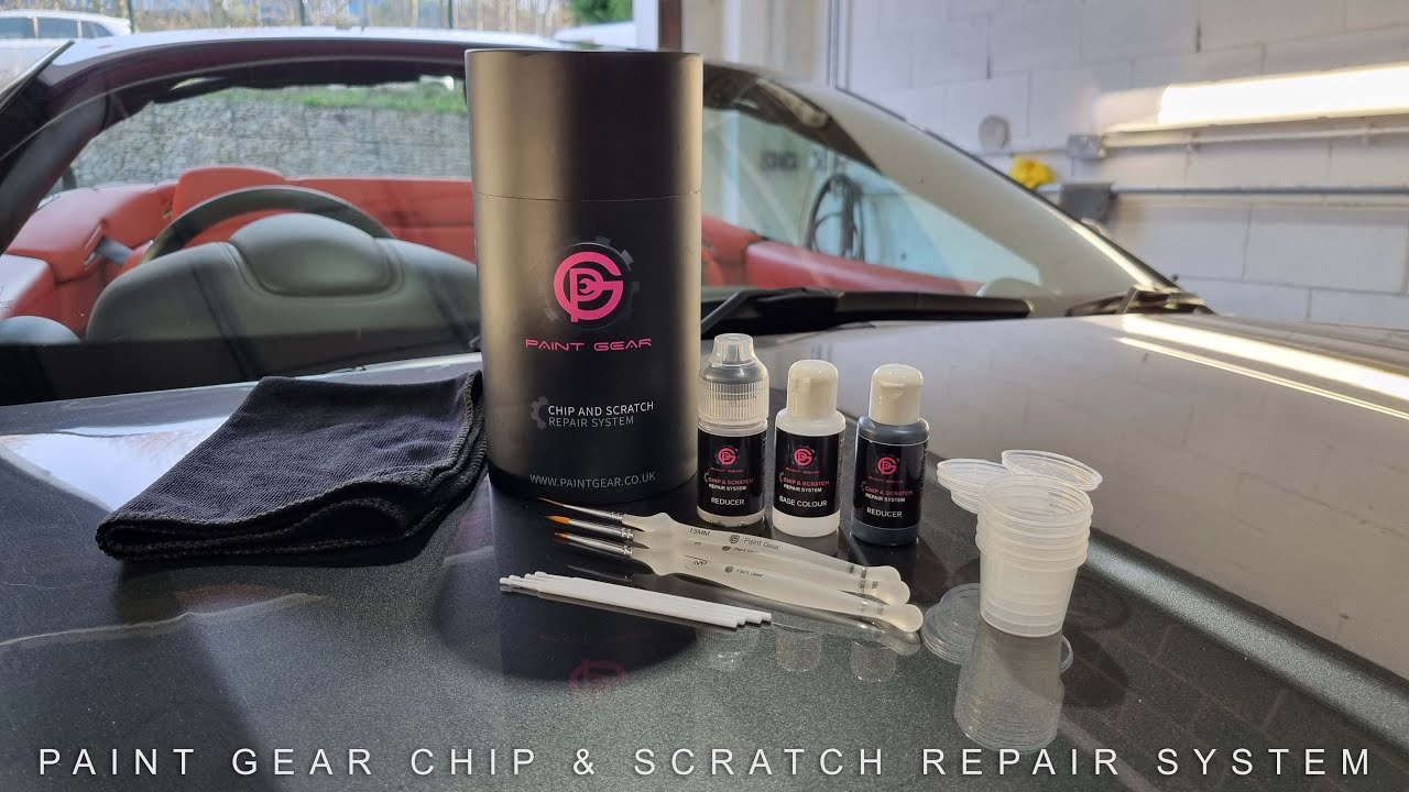

Try this guy he is a real pro at such things has his own YT channel with loads of handy tips plus his own website where he sells the paint kits matches to your car! Might save you a fortune ;)
