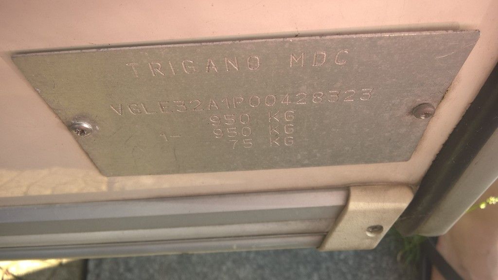

Sorry for the slight hi-jack but would I need a licence to pull my parents trailer tent?
Current car is a 15 plate 2.0tdi Superb Estate DSG.
Plate on side of trailer:
