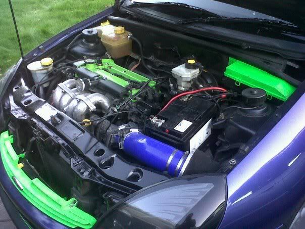

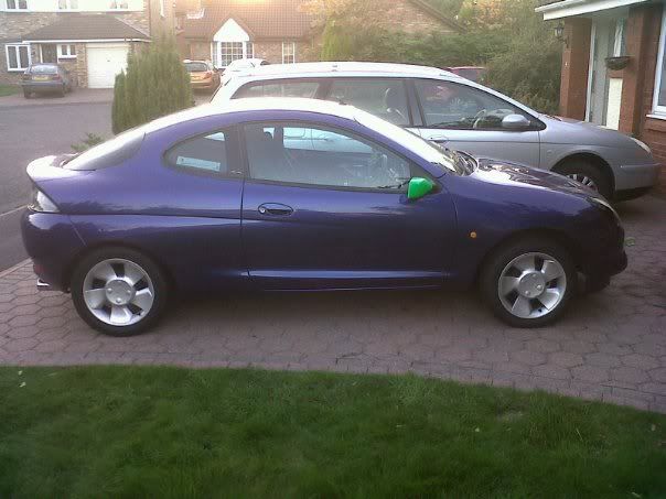

Some photos I took this evening, sorry about the quality I only had my blackberry.
