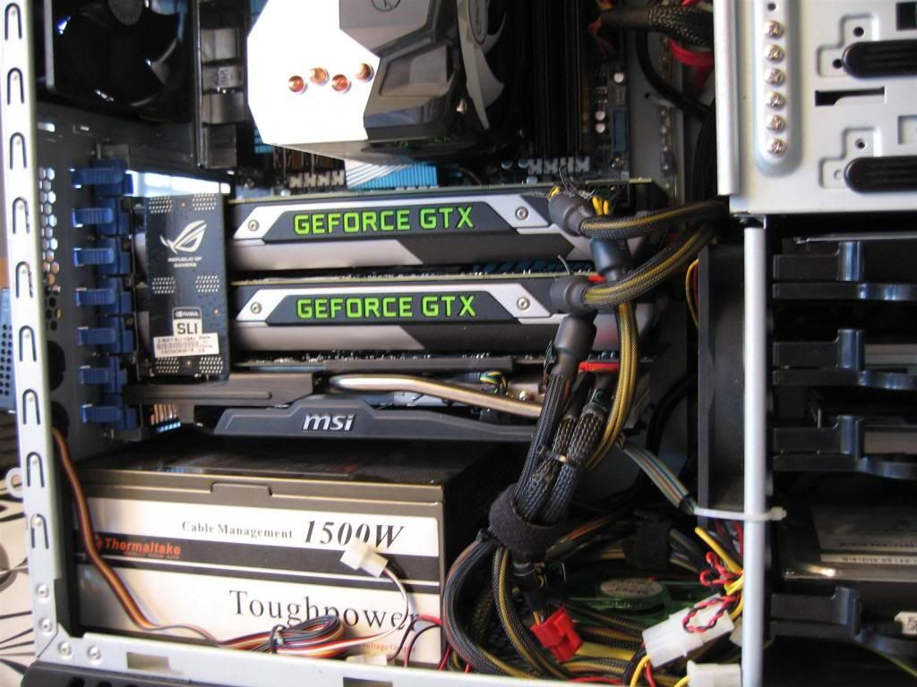

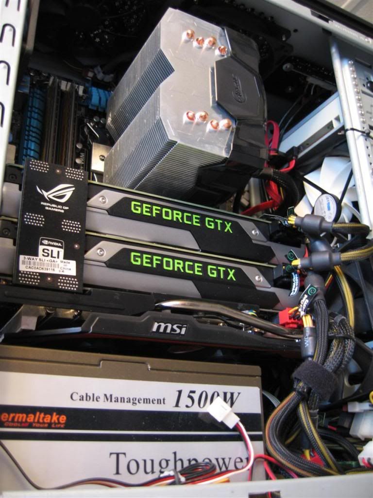

Hi,
Just got 3 x 780ti sli setup and im having a troubling problem where the top two cards are getting very hot (85oC+, even topping out at 99oC at times).
This is purely because they are crammed together with very little space for airflow to them.
Can anyone advise a solution (besides water) that will get my temps down as they are actually throttling at that temperature and my performance suffers badly.
I was thinking of getting an Antec spot fan and putting it at point blank range by the two top cards (third card temps are fine).
There is something very wrong there as I have run four Titans on air with no problems.

Any pictures of your setup? I have the Elysium which is pretty giant for airflow, with 200mm side intake. But I don't understand how it's reaching those temperatures with no adjustment to power limit or temperature limit.
