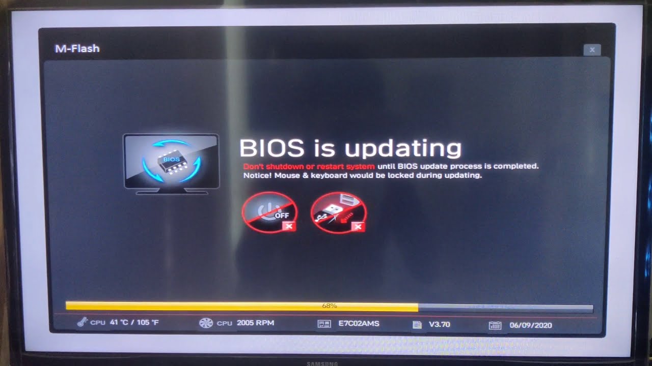

Another thing you can do is update the BIOS as that motherboard is 5 years old
youtu.be
And make sure the breakaway cable is firmly together.

Ive just tried to update the bios, all the cables are connected properly but still nothing, ive updated my graphics drivers, restarted the pc, switched the ports.
there are very few troubleshooting videos for this online too which doesnt help.
How To Update BIOS - MSI B450 Tomahawk Max | Full Guide For MSI Motherboards
In this video, I'll show you how to update your BIOS with M-Flash which is a tool provided by MSI.Most of the MSI motherboards have this feature in the BIOS ...
Buyer:
