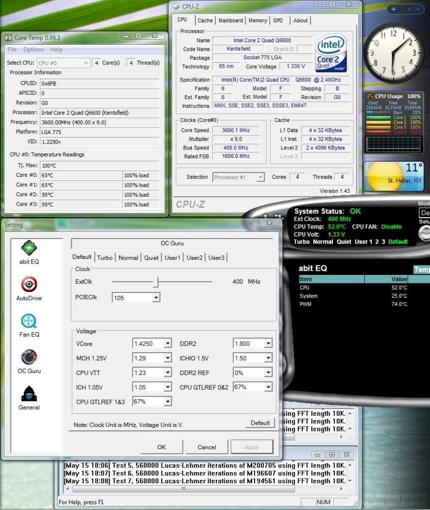

This is what I need for 3.6 on mine...
Vcore of 1.52 bios (1.42 - 1.43 under load according to uGuru)
VTT at 1.23
MCH at 1.29
the others are default.
Just keep an eye on the PWM temps. I need to run a little 60mm fan above mine to keep them below 70c at load. They can get very toasty, and WILL affect your overclock.

My settings for 3.6 GHz - my PC is stable through 5 cycles of Intel Burn Test (IBT) which needed a small boost of Vcore from my P95 settings!
